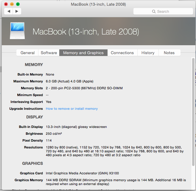

According to MacTracker, your Mac takes 200-pin PC2-5300 (667MHz) DDR2 SO-DIMM RAM. It takes a maximum of 6GB. It's probably better to have 2x2GB for 4GB.

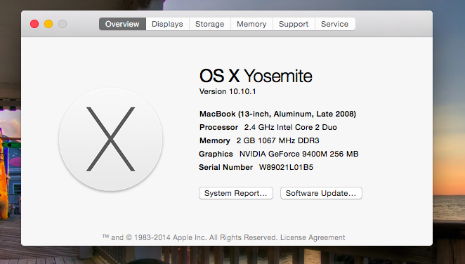

About my Mac says 1067 MHz. Is this correct?

Is it an aluminum one or a black or white plastic one?
If it is aluminun then it takes 1067MHz RAM, but the maximum is 4GB (2x2GB).
If it is plastic then it is 667MHz
http://support.apple.com/en-us/HT1651

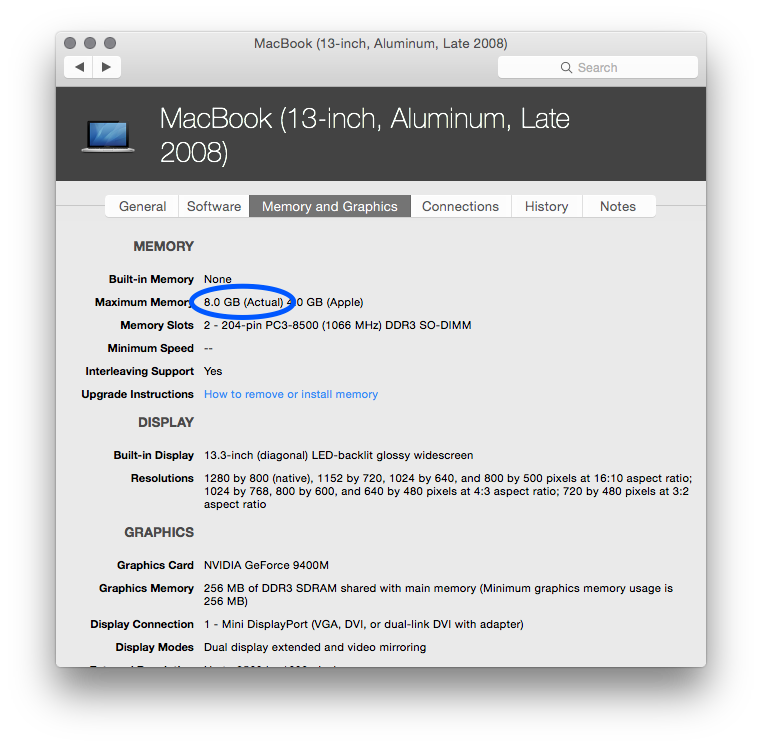

It is an aluminum. Here is my screen shot.
The Model Identifier is MacBook5, 1
On this page, it says that I can use 8 GB I believe? Am I correct?
http://eshop.macsales.com/shop/memory/Apple_MacBook_MacBook_Pro/Upgrade/DDR3
Also, thanks for taking the time out to help me with this! I greatly appreciate it! It is very helpful, and I'm going to order the ram ASAP. I'm excited that my Macbook will be become more useable again after this ram upgrade!
Yes, you can put 8 GB in there.
