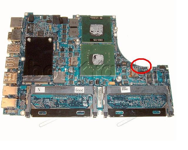

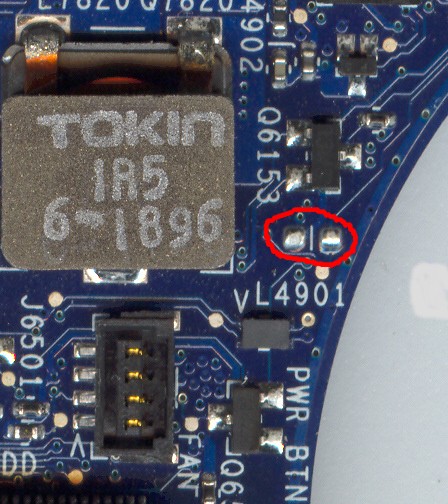

    I've done it on my plastic macbook logic board (intel core 2 duo). I'm not too sure if its the same on a Unibody, but it doesn't hurt to share my experience.
    On my macbook logic board there is a lable on the board which says PWR BTN. You will have to ground the solder point under the W or B to either one of the points in the red circle as pictured below.
    [​IMG]
    The location in the above picture is circled in the picture below.
    [​IMG]
    Hope this helps and that the Unibody has a similar layout!

    Thanks for your reply CDL0012, unfortunately the motherboard setup appears to have been radically redesigned for the unibody casing, there's nothing with the 'PWR BTN' tag, or anything resembling it, thanks anyway though.
    I'm currently downloading the service manual for the machine, I'm sure it will mention it there, I'll report back on my findings.

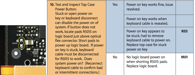

  6. JimboJones97 macrumors newbie
    Joined:
    Nov 2, 2007
    #6
    For the late 2008 15" macbook pro
    [​IMG]

    #7
    Thanks man, I'd just found it the night before, but I was too tired to post it, I'll have a go at reassembling the machine today and see if it boots up, the power is operating fine, with the battery charging and the indicators lighting up all as you would expect. I'm quite hopeful.
    Thanks for the help though, I'm sure it will come in handy for other's with the same problem!
    I'll report back if I am able to resuscitate the machine.

    It lives!!!
    After several fruitless cycles of reassembly, the system now turns on!
    I've removed the keyboard, so there's no power switch, but the system turns on normally by shorting the pins on the mobo in the aforementioned spot.
    Haven't installed an OS, I'm going to format that old 2.5" SATA drive I have kicking about and get the system up and running. If I don't find any major hard problems, I'll buy a new top case, and I'll have a top of the line 15" MBP courtesy of my Sister's clumsiness and my insurance company!
    Again, I'll report back on any developments.
