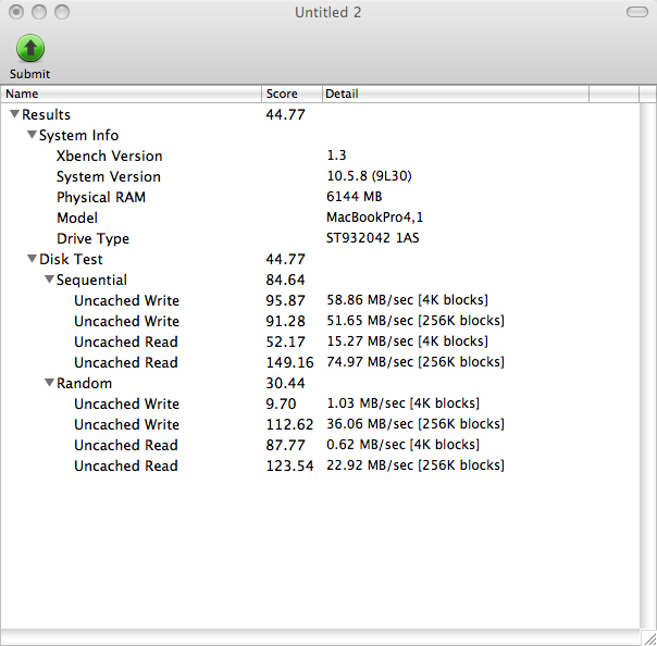

    OK, I'm copying from an internal Intel X-25M G1 SSD (so we know that's not my bottleneck) to an external 7200 rpm 320 GB hard drive (I forgot which brand, it has about 60 GB on it). Below are my XBench speeds. Note that I'm not saturating the firewire 800 connection either. It all depends on your hard drive size/capacity, size of files, and even how you're getting your benchmarks.
      File size:
      213.4 KB
      Views:
      55

    Please forgive my ignorance of the subject, and i understand if you dont want to try to explain all of the things to me in detail, but i have to ask a few questions to understand what you are saying.
    I guess my first question is, what does it mean to "saturate the FW connection". Also how do i read XBench chart you posted (or what does it mean in laymen's terms)?

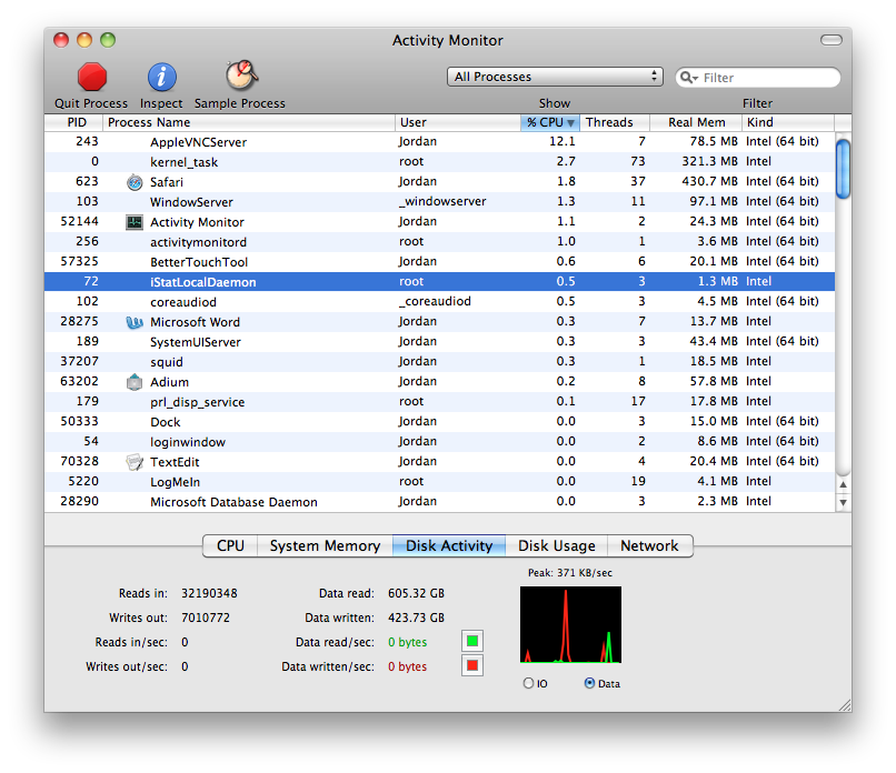

    I use the "ACT" icon on my menu bar (from istat menus) to get an idea what kind of speeds my drives are reading and writing at. I dont know how accurate this is but it is easiest thing I am acquainted with.

    saturate the connection means to physically transfer data as fast as possible across the transfer medium e.g. across FW800. i believe that you are indeed saturating it.
    dont worry about that test, its synthetic and not all that credible.
    iStat is fine and accurate, but to save having to click on the window i use the built-in OSX application "activity monitor". find it through Spotlight or /Applications/Utilities. ive attached a screen shot.
