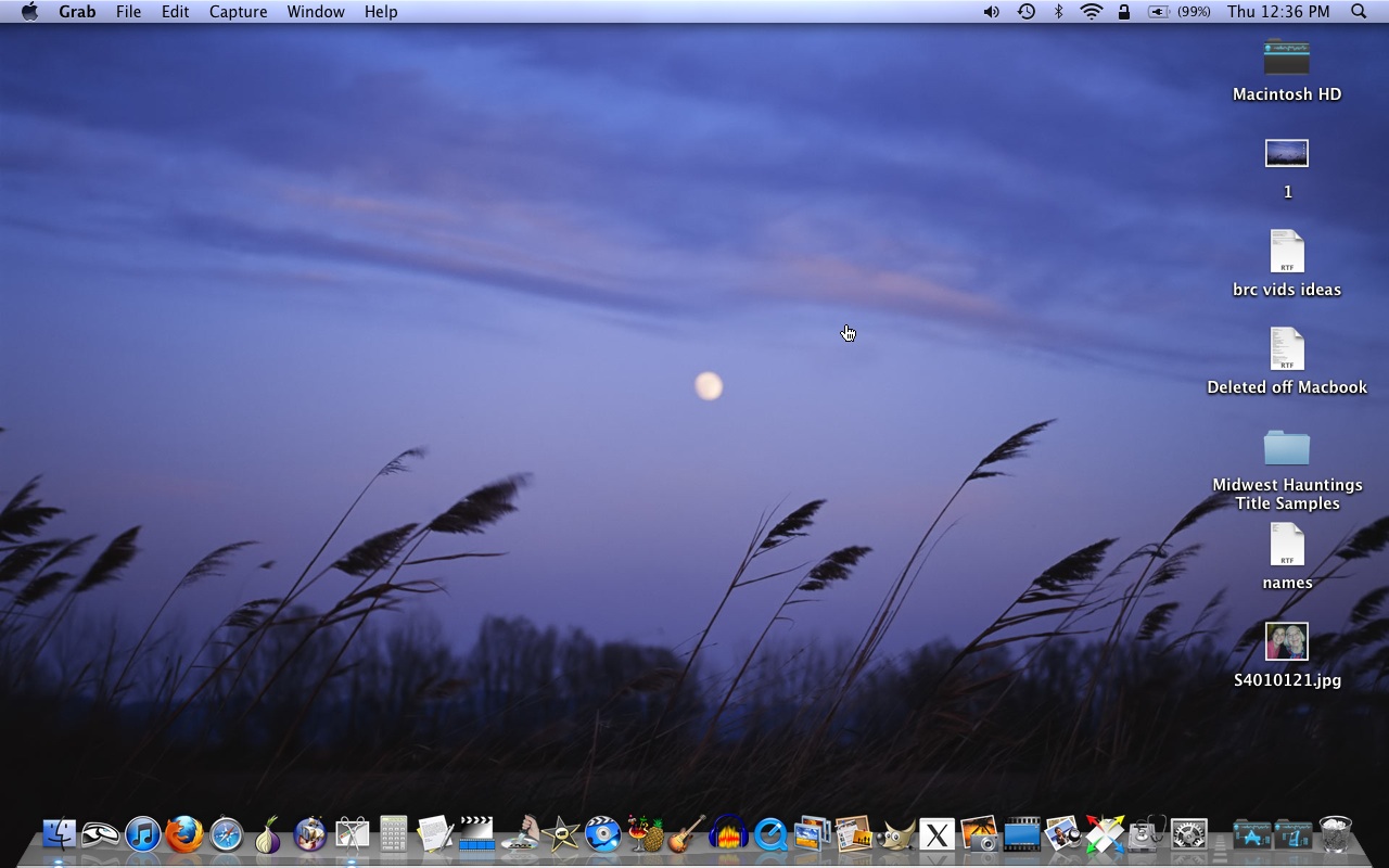

    Hey guys,
    So far that I have had my new macbook (2009) it has been really dark as a monitor. Things are crisp, and there is more contrast,
    but it makes my images and such mucher darker than other monitors, like at work and etc. Now I know all are diff, but now the monitor on my unit is making things much lighter. It depends on what day I open it, or if I shut it down or not. Now it is not the brightness button, but things now have less contrast.
    It makes things confusing because I work in photography, and web design and things should be a true color. The only thing I could think of what it was, was a loose connector on my monitor. Anyone have the same issue with this white, 13'' macbook 2009 model?
    Please let me know any thoughts.
    L

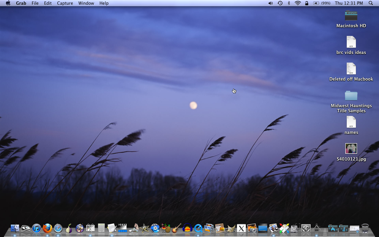

    below, 1 should be lighter, and 2 should be darker..now for me since I restarted they both look the same.

    However, it sounds more likely you're seeing a change in the color profile. Both of the images you posted look identical, and both have the same profile, so I'm not sure how that would be the case.

    I do not seem to have this ambient light option. I did calibrate it once, and it does not seem to help it. The images do look the same now, because my monitor is back to being darker. But when it is lighter they look very different. It is the oddest thing. I cannot figure out why sometimes it happens and sometimes not. I guess I will just have to deal with it.
