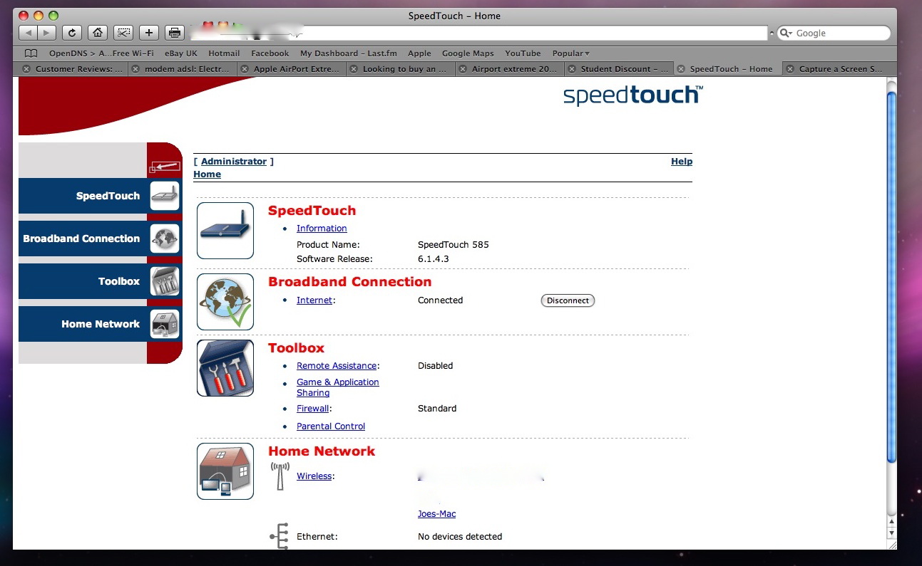

    Yep, been there, done that and got the T shirt - to no avail. Nothing worked when I tried it with Transmission.app.
    Attached is an image of my Speedtouch web UI:
    Where do I go from here? Bear in mind that I do *not* yet have the AEBS but will do soon...
  24. belvdr macrumors 603
    Joined:
    Aug 15, 2005
    Location:
    No longer logging into MR
    #24
    What's under "Game and Application Sharing"? Also, once you port forward to your IP on the Thomson, it will work once you setup your AEBS under bridge mode, and a different SSID.

  25. joelovesapple thread starter macrumors 6502a
    joelovesapple
    Joined:
    Sep 25, 2006
    Location:
    UK
    #25
    It is - it has the title of this thread, if that is what you meant?
    Yeah I tried Game and application sharing several times; maybe I just wasn't doing it right... I usually like to conduct experiments to see if they will work but I've never quite cracked port forwarding. Didn't do so on the belkin either.
