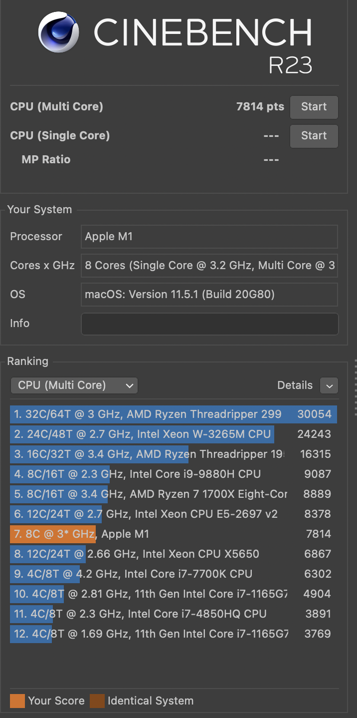

FWIW M1 13" MBP 8GB base model, macOS 11.5.1, Cinebench R23; 30 minute run, ambient temp 26C, max temp 92C, max fan 4.5K RPM, max battery temp 32C, scored 7814 pts.
Monitored by Macs Fan Control, fan set to Apple default setting.

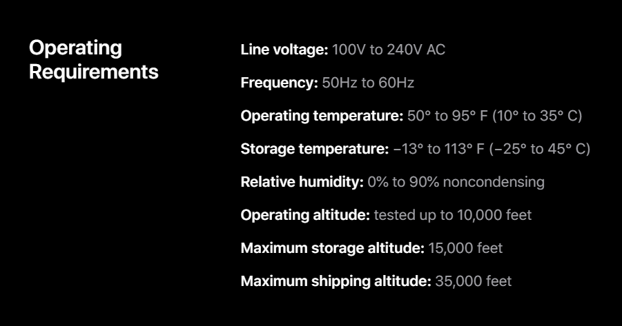

At 30C ambient your approaching what Apple considers to be the upper limit for operation. which translates into a disclaimer for potential reduced performance and or battery longevity.

That probably does matter as others have noted the Air can only passively radiate the M1's heat so the warmer the ambient temperature, the less effective that radiation is.

I did an experiment. I turned on the AC and set it to 21C. After 1hr (when room temp was constant at 21C) i started the Cinebench R23 benchmark. The 30 minute result was at 6700 points. When the room is 29-30C the 30 minute test is at 5400 points.
I also observed that the powermetrics tool reported a 10W draw even during the late stages of the benchmark.
I haven't gamed on it because the room felt too cold (it's funny how it feels cold in the summer at 21C and when it's winter 21C feel warm).
I'm starting to think that the room temperature actually makes a big difference, but i still need to do a few experiments.
