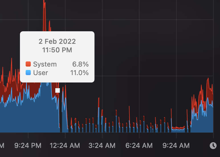

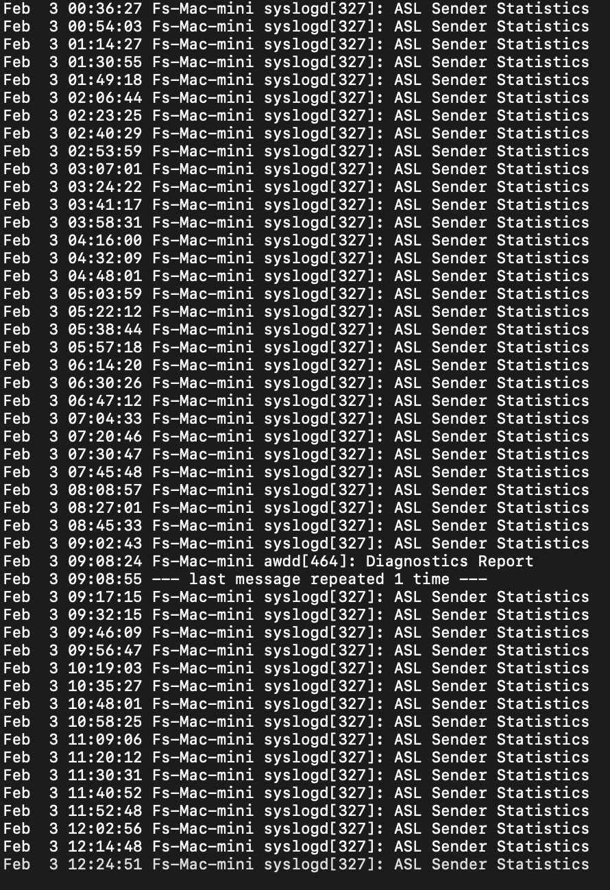

My mac mini keep waking up every 15 mins during the night. The timing coincides with this system.log message

I have an external HDD and a USB hubs (With Type c to hdmi, connected to a monitor) connected to the mac mini. Is it the source of the problem?
