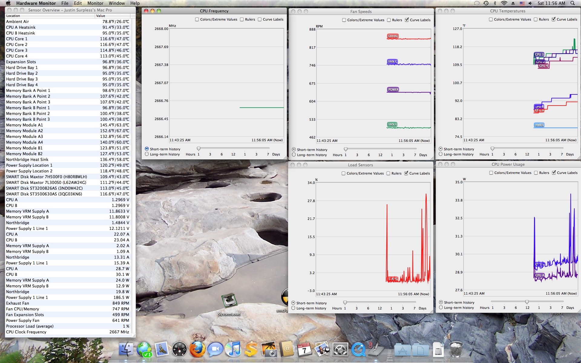

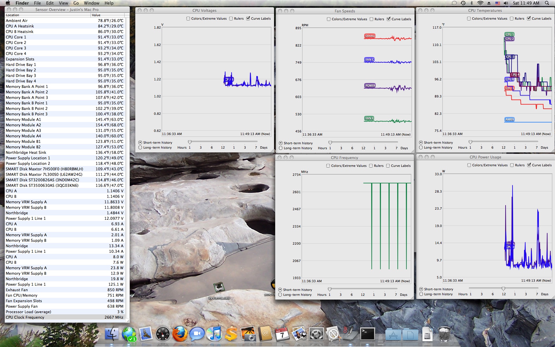

    Hi everyone
    I've got an original Mac Pro 1,1 (2.66) that I got way back in '06... having upgraded from a Quad G5, I was stunned at how cool it ran (90-100F at idle vs 130F or so at idle on the Quad)... was very pleased with that...
    Then last May, I happened to be moving things around in the back and noticed that the exhaust air was *very* warm... thinking this was odd, I fired up Hardware Monitor and was stunned to discover the CPU cores idling around 125F...
    Long story short - after much testing, cleaning and all that - I happened to stumble on the cause... well, the reason more than the cause... for me, running OS X 10.5.3 and later causes my CPUs to draw around 30W each at idle... this is what OS X 10.5.2 draws under load (vs 8-10W at idle)... 10.5.3 and beyond have only marginal differences between idle and in use for power (like 30W => 33W or so)
    As I noted in my other thread Mac Pro 1,1 CPU Draws MORE Watts @ OS X >= 10.5.3, it seems to be related to the AppleCPUPowerManagement extension... if I remove it, the issue goes away but alas this renders the MP unable to sleep without a KP...
    I've posted screenshots of Hardware Monitor under both OS X 10.5.2 and OS X 10.6.4... I'd like to see what other Mac Pro 1,1 owners are experiencing? At least one other (Alfihar) posted screenshots of his system that ran low power... can others report as well?
    Many thanks in advance
    -Justin

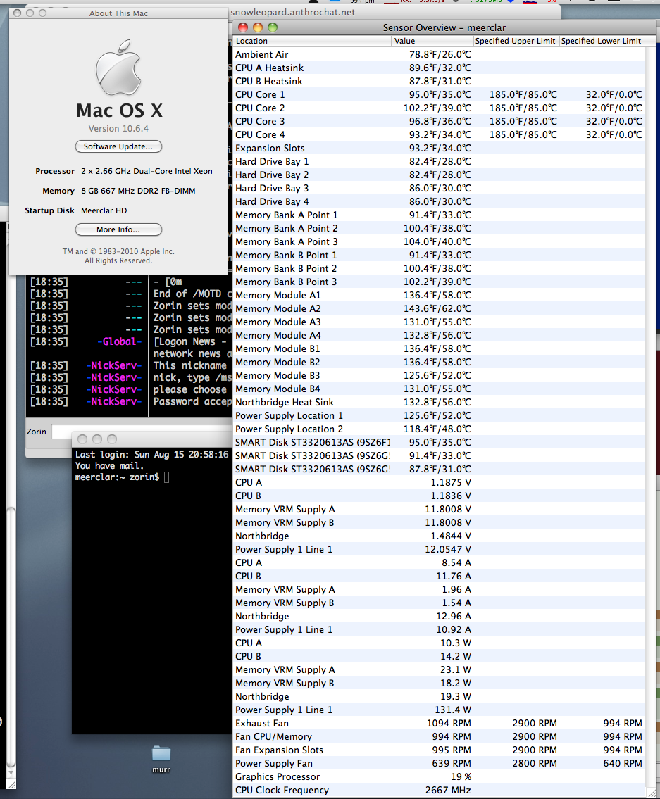

  8. zorinlynx macrumors 603
    zorinlynx
    Joined:
    May 31, 2007
    Location:
    Florida, USA
    #8
    Hiya!
    Nope, no hot CPUs on my own Mac Pro 1,1. (screenshot attached)
    Heck my memory is running hotter than the CPUs! This is on an idle system. Are you seeing 125F under load or idle?
  9. jsurpless thread starter macrumors member
    Joined:
    Aug 6, 2009
    #9
    Thanks for the note - it's definitely under idle - if you check out my screenshots (the one on the right is 10.6.4), you can see low CPU usage and my CPUs drawing ~30W (vs your 10W)...
    This happens on a fresh brand-new install with *nothing* connected to the Mac Pro...
