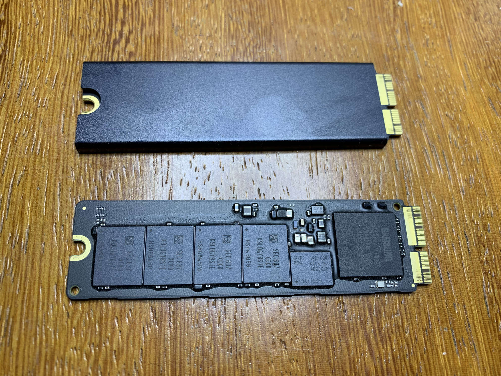

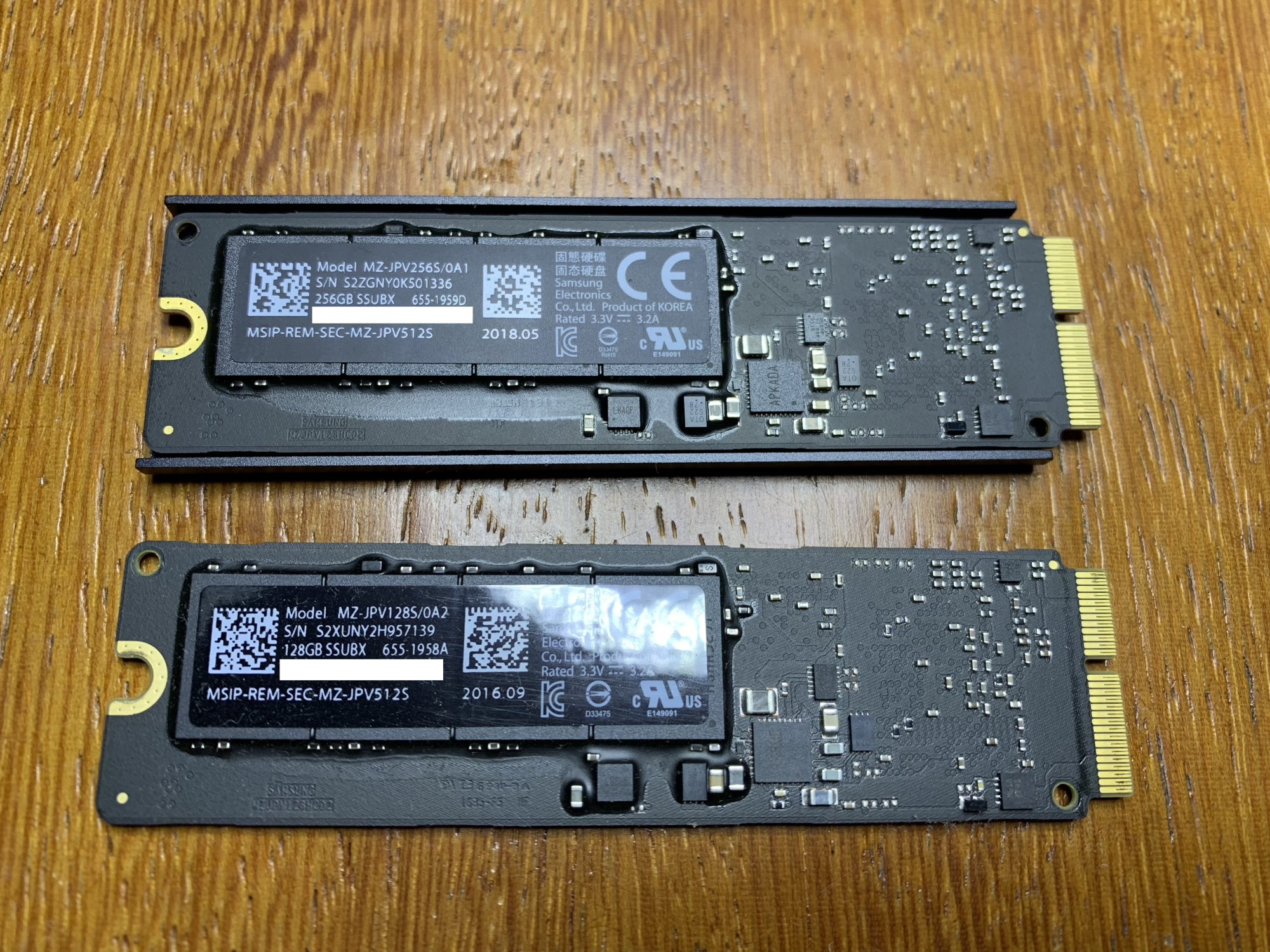

Check if it's the original SSUAX or SSUBX with the original Mac Pro heatsink. See below two SSUBX blades, the blade with a heatsink is the SSUBX 256GB from a 2018 made MacPro6,1, while the non-heatsinked 128GB is from an early-2015 13" rMBP (also works fine for upgrading late-2013 Mac Pro firmware).
Reactions: bernuli

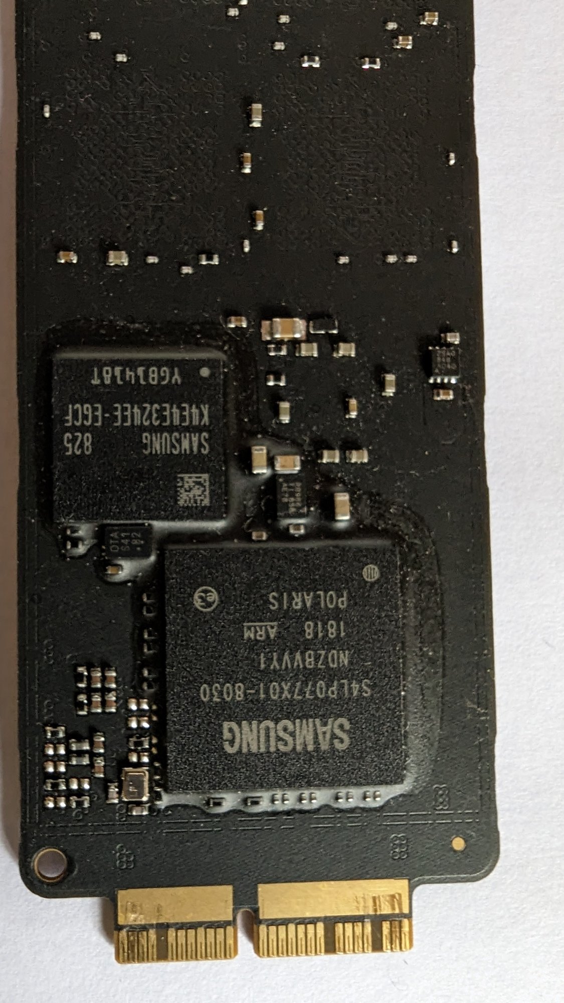

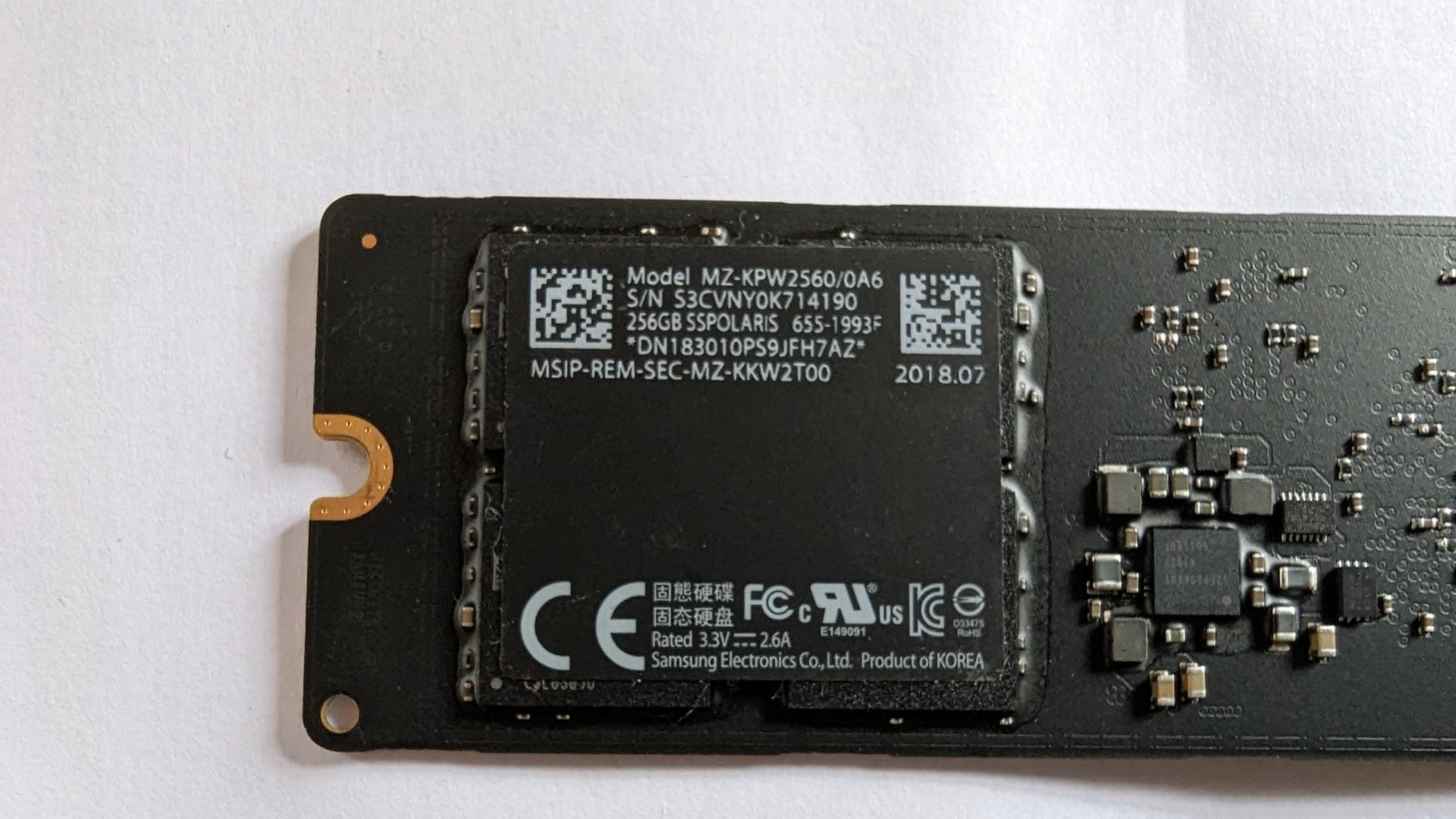

Damn, guess this isn't original then!!
Probably the last Mac Pro batch made right before the 2019 production started, and any factory refurbs made after, could have a SSPOLARIS right from the factory, I don't doubt it, but then the firmware would be a lot newer than 132.0.0.0.0 - a version from High Sierra - and Mojave would be the factory installed macOS release.
Btw, my personal late-2013 was made back in the second half of 2018 and you saw the SSUBX from it in the pictures. So, Apple used SSUAX & SSUBX at least until that.
Reactions: bernuli
Forgot another thing, all Mac Pro blades are heat-sinked from the factory. SSPOLARIS if installed by the factory to a Mac Pro would have a heatsink.
Reactions: bernuli
