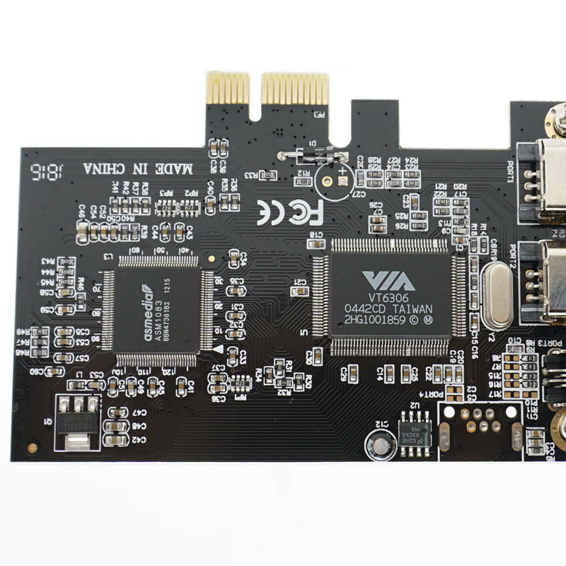

[doublepost=1532253155][/doublepost]the worse, can i buy another pcie firewire to work with? i see on ebay having vt6306, 6307, 6308, so which one should i buy for my mac pro please? thank you so much.
