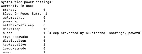

Theory re power management: care to try "pmset -g" and post a screenshot? Here's mine:

This appears to be fixed in the newest beta of Ventura (at least with the Dell UP3218K). No dropped frames now with "Displays have separate Spaces" unchecked.
