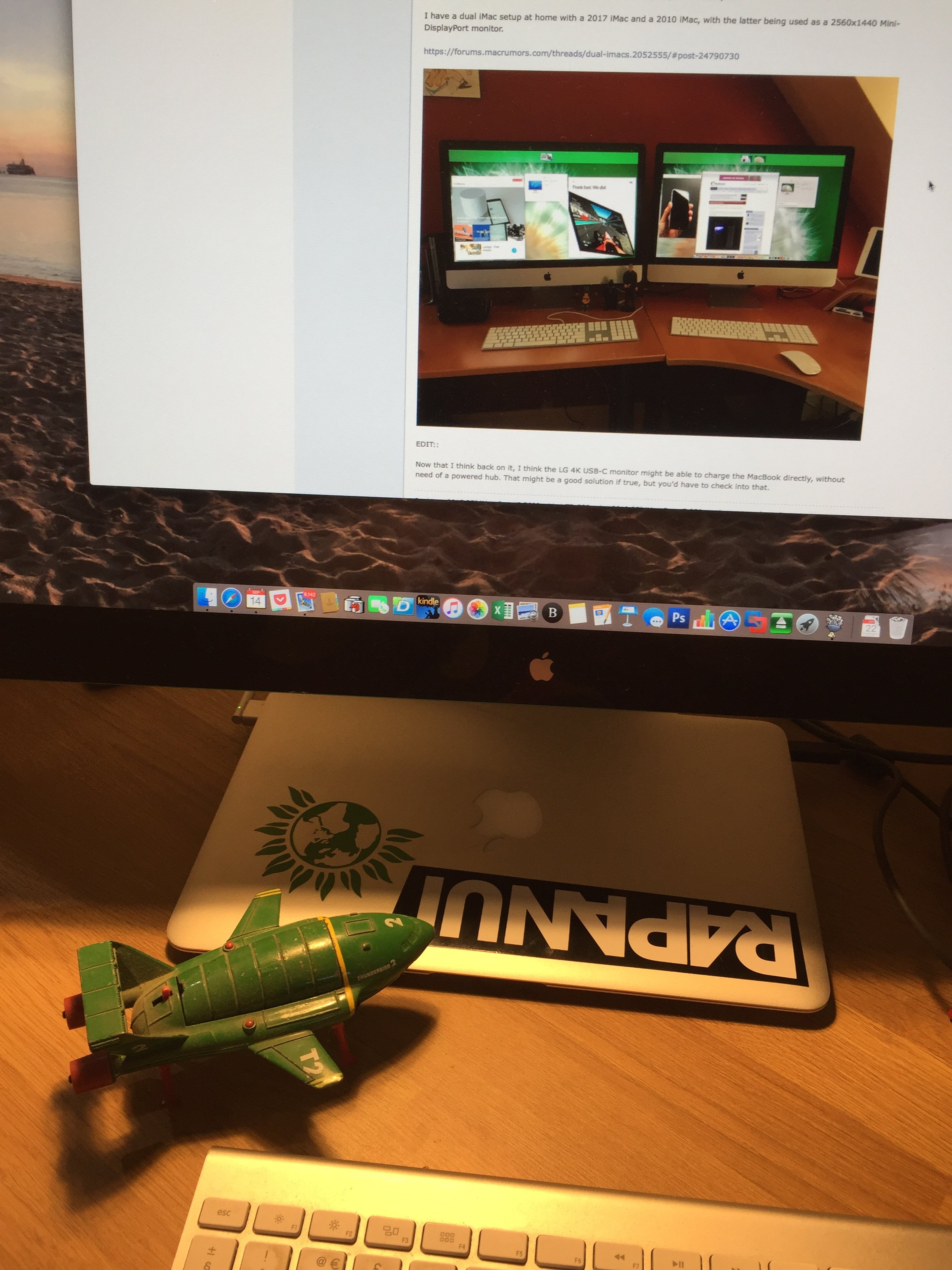

Thanks EugW. I have ordered the LG 27UD88. It does power and charge the MacBook so seems a good all-round solution, with the limitation of the USB 2 speed. I will deal with that issue somehow. I will comment back here how it all goes.
Thanks for the help. If your little (Star Wars?) dudes need a lift I have Thunderbird 2 on hot standby :D
