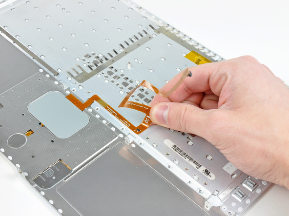

When my Blackbook gets around 4000+rpm, I feel air being pulled in through the centre part of the keyboard. Not sure where the air is going, but air does move through the keyboard.
It doesn't, actually. You're feeling the draft of the air moving from the vents in the rear and hitting the screen. There is no venting possible through the keyboard, as it's sealed. You can look at all the photos from the iFixIt teardowns as proof, if you don't want to open your Mac to see for yourself.

The piece-of-paper-sticking-via-suction-test shows otherwise. I've seen the inside of my Blackbook's and the underside of the topcase and ssw few holes, but air does move through my keyboard. Just enough the hold a standard piece of printer paper when the Macbook is tilted at angles that should make the paper fall off. Even putting the paper along the top row of keys and against the screen to block hot air from the keyboard I still feel moving air being pulled into the top centre of the keyboard.
That's not venting. If you look inside, both the intake and exhaust vents are in the rear, near the fans. There isn't enough air moving around or through the keyboard to provide any venting or cooling, and the design of Apple notebooks has never depended on airflow through the keyboard for cooling. If that weren't true, Apple wouldn't give instructions on how to operate in clamshell mode. Clamshell works because the vents are still exposed with the lid closed.

It's still air entering the machine from an external source that assists in cooling. No matter how little, having the machine open can reduce temperatures.

While heat radiates in all directions and dissipates through all surfaces, there is no air intake or exhaust venting through the keyboard on any Mac notebook, and there never has been. Both intake and exhaust is through the vents in the rear near the hinge, which allows venting with the lid open or closed (for operating in clamshell mode). There is a solid panel under the keyboard, preventing any meaningful airflow.
I know there is no physical holes but closing the lid adds another layer for the heat to get through.
It's heat dissipation, more than any airflow, that is affected by having the lid open. If Apple depended on airflow through the keyboard for cooling, they would leave it open to maximize such airflow, instead of blocking it, as in this picture of the underside of the C2D MacBook keyboard:
That's right. It's dissipation, not airflow that is affected by having the lid closed. Still, it's not enough to significantly affect operating temps.

The little airflow that it does allow does make a difference. For the few months that I used a keyboard skin on my Blackbook its idle and maximum temperatures was slightly higher than without the skin. The temperatures also rose faster and fell slower with it on as well. It does baffle me how the air works its way through the keyboard.
I can verify this. When I use the screen protector in clamshell mode, the Air runs about 10C higher, than without. So there is airflow through the Air keyboard.
