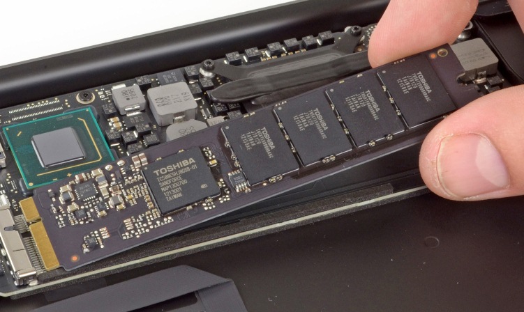

  7. Daniva, Mar 4, 2016
    Daniva macrumors member
    Daniva
    Joined:
    Sep 7, 2013
    Location:
    Italy
    #7
    Now you are certain that the GPU soldered with the logic board is healthy
    Please, don't consider june 2013 as the deadline of SSD Replacement Program because "The program covers affected MacBook Air for three years after the first retail sale of the unit. Apple will continue to evaluate service data and will provide further updates to this program as needed"
    p.s. you still haven't said which model you have. If it's a Mid-2012, Apple will replace your SSD for free
    [​IMG]
  8. thesituation thread starter macrumors member
    Joined:
    Oct 31, 2010
    #8
    it is the mid 2013 model, the ones that were released with the Haswell processors. I believe the SSD on mine is Samsung. Not too sure however, I can't check because the drive is not working at all.
    Is there any software that I can use that will bring my SSD alive?
