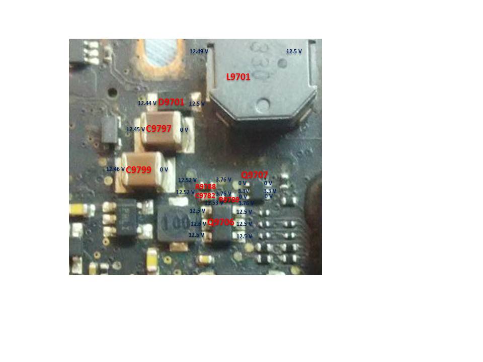

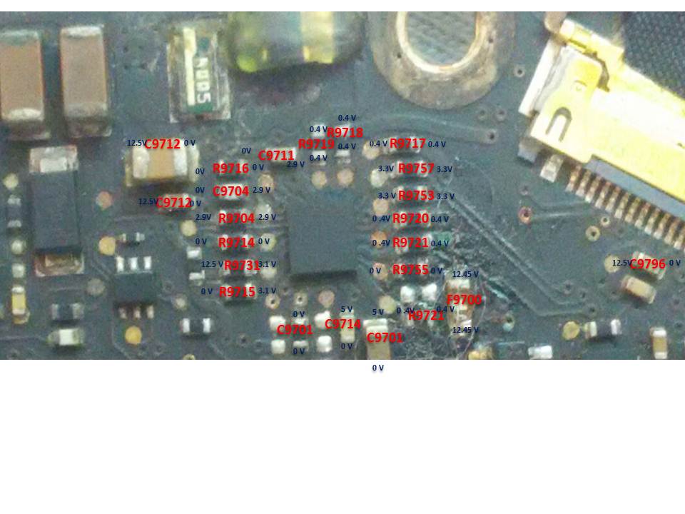

Hello guys I have an 820-2936 Macbook pro late 2011 13'' i5 A1278
I Have chimes and display but unable to get back light
I can see the image using an flashlight from behind
I have checked the display by connecting to an working screen, but it too doesn't have backlight
board has LP8550 WLED driver
and it doesn't boost output
I have an feedback of at
PPVOUT_SW_LCDBKLT_FB probe 613 12.5v
I am posting all the readings in the pictures
Kindly guide me to help me find what the problem is,
am i supposed to replace LP8550 .
Please guide me
Thanks in advance :)
