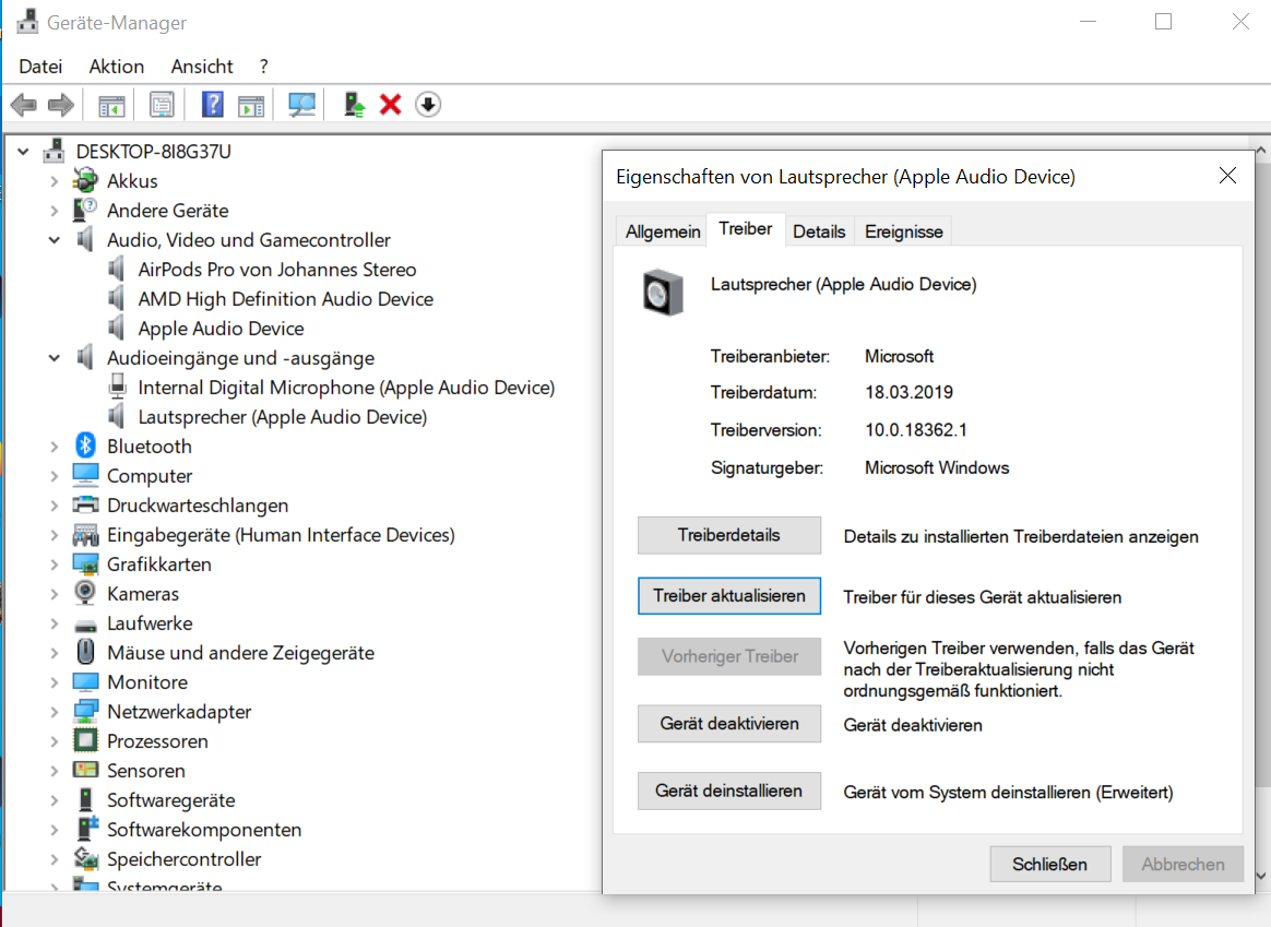

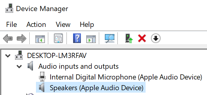

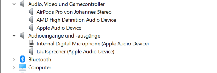

Can you get a picture or screenshot of the audio devices in Device Manager?
Yep

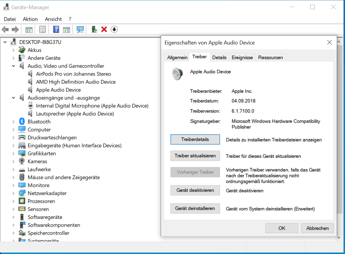

Can you also get the driver version of the "Apple Audio Device"? Based on my preliminary research and my past experiences with Windows, this is often caused by the way that the system is imaged in relation to its EFI firmware. Did you use the "Windows to Go" option within Rufus?

I don't know about the headphones as I don't have airpods, but as for the sound on speakers I downloaded all macbook pro drivers (not only the specific ones for my macbook pro 16'') and updated the audio input > speakers (Apple Audio Device)
I uploaded the drivers to my google drive so you can download them. Important to note that I can't seem to remember which of the 3 folders contains the drivers that worked for me - I'm almost sure it's this one (AppleAudio_1889106B) but please try until you see that the system is installing the drivers and not saying that it couldn't find any other best drivers.
