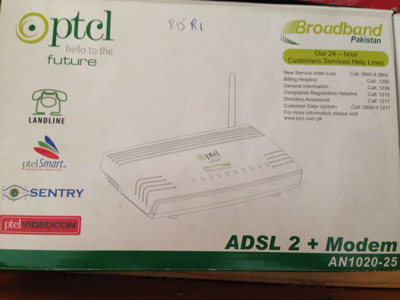

    Router/Modem = PTCL ADSL 2 + Modem (AN1020-25)

    For starters that's an ancient 802.11b/g router, I'm going the venture it's probably pretty awful.
    Make sure the firmware is up to date.

    router sounds suspect (and old) contact you ISP for replacement.
