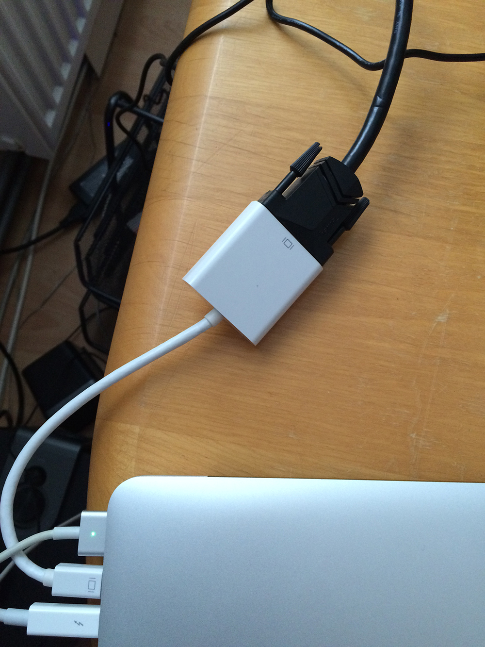

    I just bought my first and new external monitor LG 34UM65 21:9 UltraWide (34") for my Macbook Pro Retina (MID 2012)
    Link to monitor: http://www.lg.com/us/monitors/lg-34UM65-P-ultrawide-monitor
    I connected it via DVI to DisplayPort (also tried with HDMI, same issue)
    [​IMG]

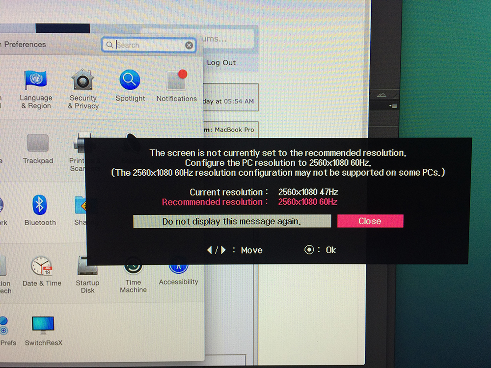

    First:
    I reached the almost recommended resolution with the software SwitchResX, by adding manually the custom resolution, without that software, the OSX didn't show me the resolution.
    [​IMG]
    My configuration of SwitchResX:
    [​IMG]
    The issue is that I'm not really satisfied with the quality it gives me. The text quality, the font, looks kind of fuzzy or jagged (and yes, I have the LCD font smoothing activated)
    Is it normal? Have I done something wrong? Can I reach better quality?

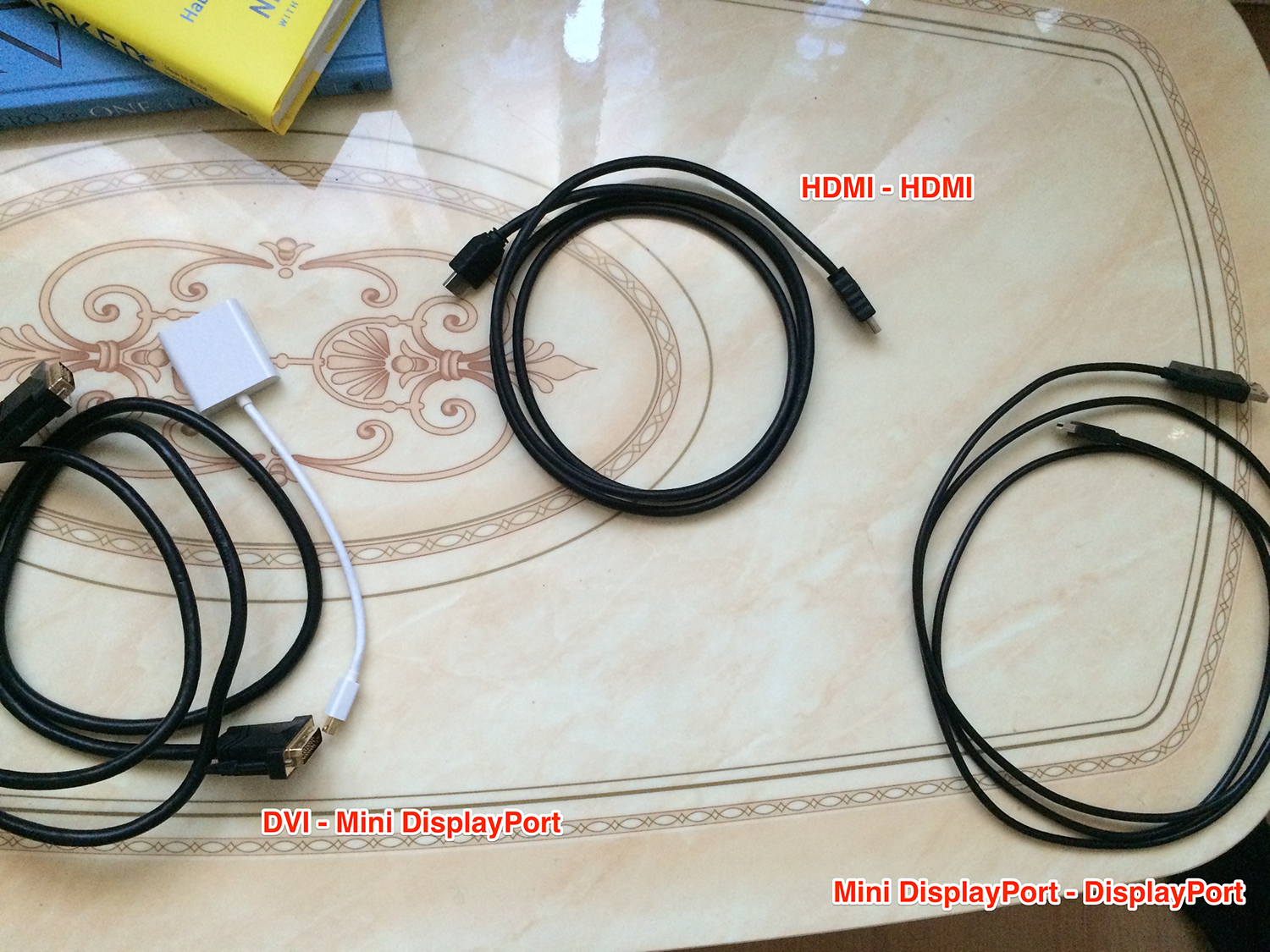

    I did, same resolution but native this time..
    Tried 'em all:
    [​IMG]
    Best so far, the Mini DisplayPort to DisplayPort, I can reach native resolution without software, although, the quality is the same.
    I guess I am too picky.. but as a Web Designer, every pixel matters for me. I rather give some extra bucks for a better quality. Initially, I thought the 2560x1080 would be enough for me, but I'm wrong.
