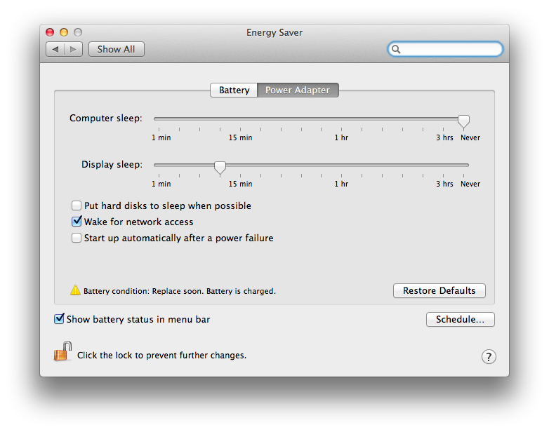

    I just updated to Mountain Lion (10.8.2) from Snow Leopard (10.6.8) on a 2008 Macbook Pro. After updating everytime I close the lid to put it to sleep, upon re-opening the computer reboots. At first it seems to try and wake up but then just restarts.
    I have not enabled this in System Preferences -> Energy Saver (see screenshot).
    Can anyone suggest what might be happening? :confused:

    There is a known bug in 10.8.2 concerning deep sleep behaviour. Lots of posts on this subject on the forums. I suggest you try plugging the Macbook Pro into the mains, closing the lid, leaving it to sleep, opening the lid. If it is this bug, then the MBP will wake OK and not reboot. The problem seems to be when running on battery.
    If you still have the problem then wait till 10.8.3 is out (not long now) and try again.
    I have this problem with a 2011 MBA. If 10.8.3 doesn't solve this then I'm going back to 10.7.X. The problem seems to be specific to 10.8 and mostly to 10.8.2.

    Wow that is quite some bug! Thanks for replying with the news.
    My mac does it even when plugged into the mains power so it would appear not to be the bug you are referring to. It is a pretty major inconvenience too.
    Is there anything else I can do or check?
