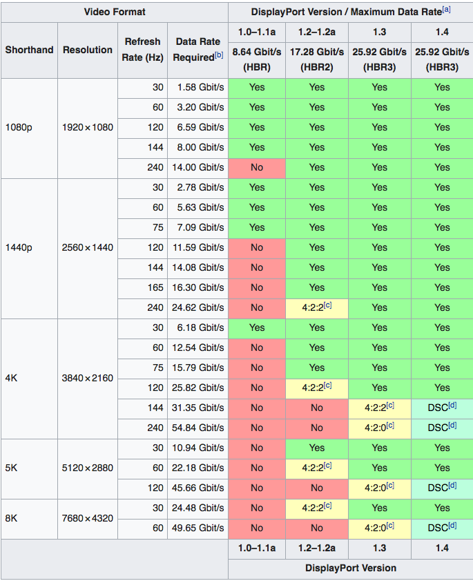

Why do I beleive the LG 34WK95U should work at 60hz and native resolution (5160*2160) using the Usb C entry on the monitor and the TB2 (DP1.2) port on the Mac Pro late 2013 (thus a Usb C to TB2 apple connector)?
Please check the following table (source https://en.wikipedia.org/wiki/DisplayPort)
It tells you that the bandwith of DP1.2 (standard supported on TB2 from Mac Pro late 2013) is 17,28Gbit/s.
This is the maximum bandwith of each of the 3 controllers of the Mac Pro Late 2013.

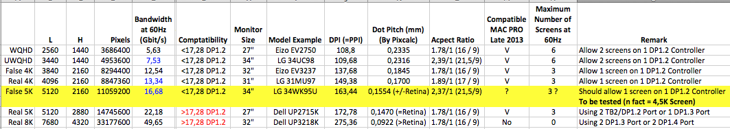

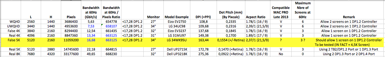

Using this table plus the web site from https://www.pxcalc.com/
and calculating additional intermediate resolutions, I come to the following table:
This shows that the LG 34WK95U should use 16,68Gbits/s bandwitdh at 60Hz and native resolution, which is just under the max. supported bandwitdth of a DP1.2 Controller, and the Mac Pro Late 2013 has 3 of them.
Please let me know if you know someone who could test this config.
