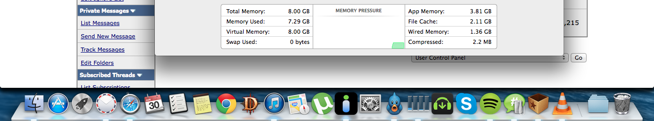

  8. Prabas macrumors 6502a
    Prabas
    Joined:
    Sep 14, 2010
    Location:
    Europe
    #8
    Performance in 10.9 has increased dramatically for me.
    RAM is supposed to be used, it isn't Windows, where you have 8GB and you can't even go past 2GB of RAM usage.
