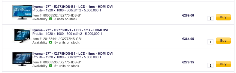

    I'm getting a new 2012 MBA 13" over the coming weeks. I've been thinking of pairing it with one of these Iiyama 27" monitors ...
    [​IMG]
    The image is from this website here.
    The product website states the input signal can be DVI-D, VGA, HDMI, 3.5mm Jack. So what would be the best cable to use with my new MBA to connect to this monitor?
    Also, any opinions on which is the best of those 3 monitors?
    Thanks in advance!!

    A Thunderbolt or MiniDisplay Port to HDMI adapter. Apple sells one, I believe Monoprice has some also.

    The HDMI adaptor would be fine as it can output up to 1920x1200
