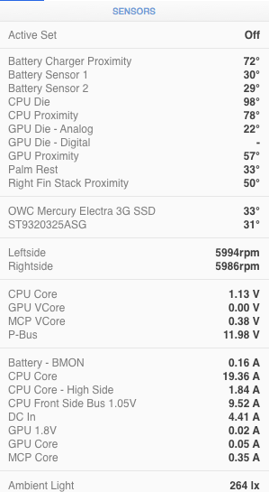

Please see my iStat numbers. CPU is going crazy and the laptop is completely idle.

Strange problem. Perhaps attempt disconnecting the fans and the battery and plug it all back in again.
