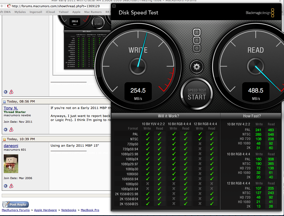

    Where is the FUD coming from that 000F is slow. I've been running it for weeks now and my speeds are just dandy

  8. daneoni macrumors G4
    daneoni
    Joined:
    Mar 24, 2006
  9. IngerMan, May 17, 2012

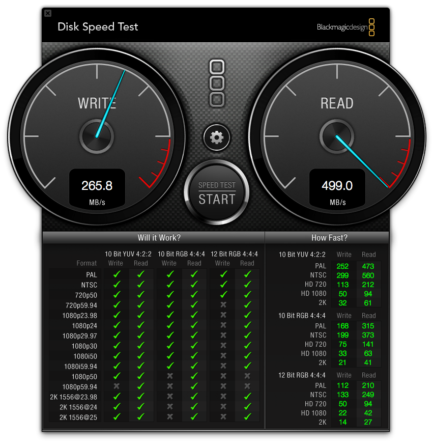

    Early 2011 2.0
    No problems with my 000F upgrade
