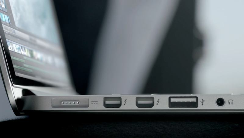

    I agree. Here is what a normal port looks like:
    [​IMG]
    It looks like that port has been arcing for a long time. I would get those out of there right away.
