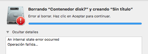

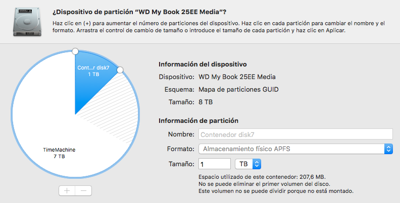

I have a similar problem: External USB of 8TB, split into 1TB work and 7TB Time Machine. Later i decided to use the full disk of 8TB for TimeMachine. The system does not allow to delete (borrar en español) the work partition. Captura de pantalla 2017-11-10 08.10.13.png

I have a similar problem: External USB of 8TB, split into 1TB work and 7TB Time Machine. Later i decided to use the full disk of 8TB for TimeMachine. The system does not allow to delete (borrar en español) the work partition. View attachment 734230
I don't believe you can delete the first partition on the disk.
You may have to look at shrinking the Time Machine partition down and increasing the first partition tie so you can copy the data between the partitions. Then delete the Time Machine partition and expand the first partition to use all the space.
Or backup your Time Machine partition (yeah, backup the backup lol), repartition and then restore.
