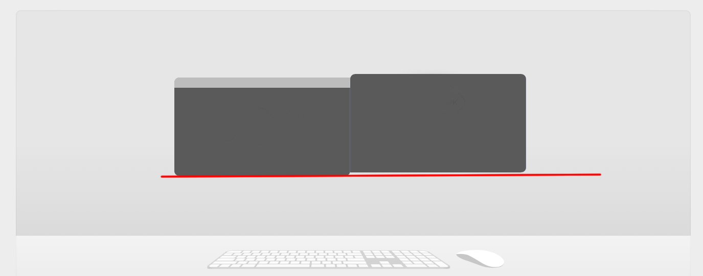

Unfortunately the Quick note popup in the lower right corner is not activated when my monitors are positioned on the same height. A solution is to set the right secondary monitor slightly higher but nonetheless a shame it is not working without doing so
Reactions: jeffscott
I was frustrated by this too but didn't think of the solution you offered. It works perfectly for me – thanks!

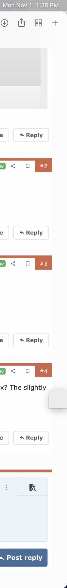

The popup also shows up about 1/3 above the bottom for me when using an external monitor. Anyone know a fix? The slightly higher display did not work for me.
