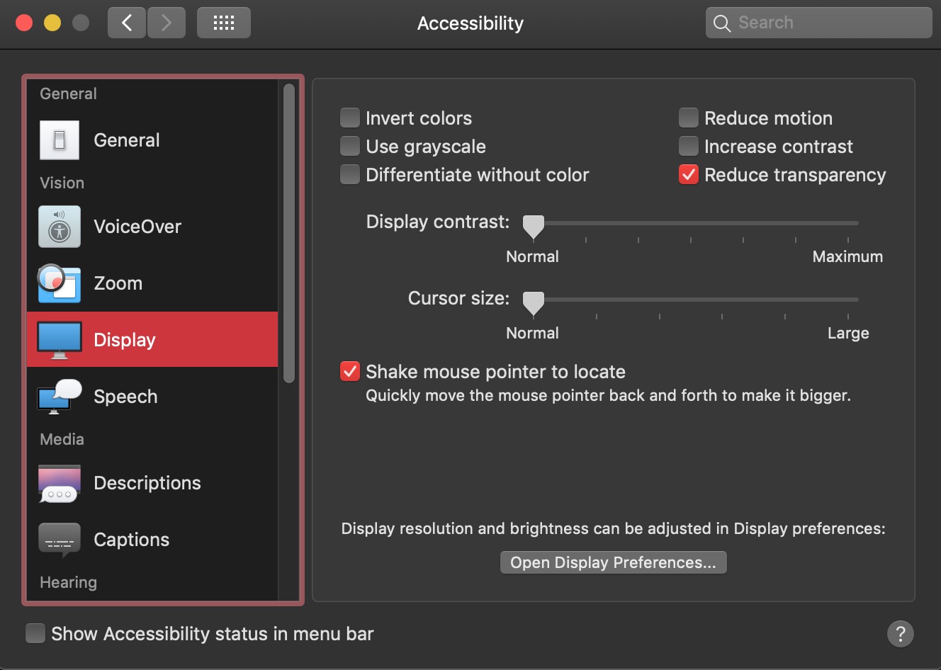

I just purchased a new keyboard and mouse combo. I have found the same problem in previous macOS and combos too.
The "cursor becomes bigger than usual and then back to normal" sometimes with out any reason. And it started to happen and happens a lot recently.
What's causing the problem? How do I fix it?
I think you have "Shake mouse pointer to locate" enabled in System Preferences...>Accessibility.

I purchased the combo for about a week. The first few days everything is okay. And it started to have problem(even quite often) since the day before yesterday.
Deselecting the "Shake mouse pointer to locate" helped. But I still don't know why it had problems at the first time.
