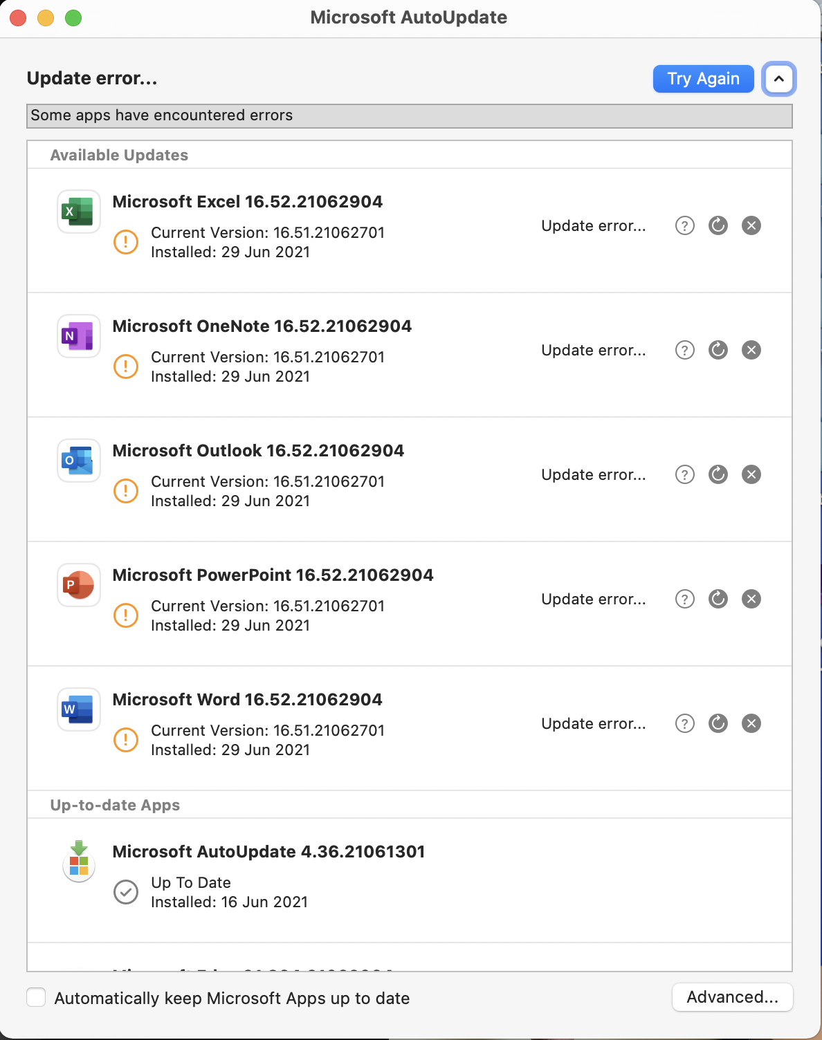

Same problem here... beta channel

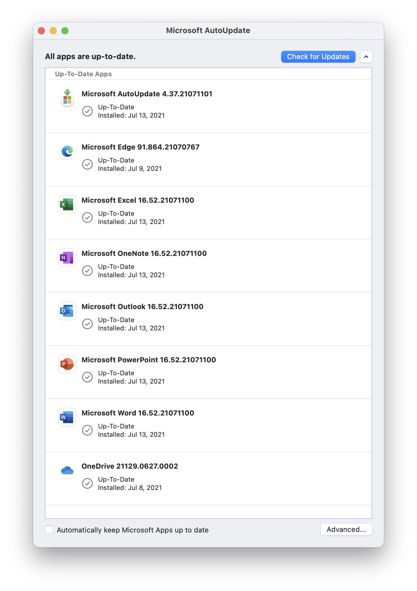

Well, it's still not working, so I decide to dip into the AutoUpdate log files (specifically TelemetryUploadFilecom.microsoft.autoupdate.fba.txt) to see what I could see. And there's a pattern with every failure.
Every time an update fails, it fails with a RemoteInspector XPC connection to relay failed error.
Code:
[Microsoft Update Assistant] <Error> InstallUpdatesTask.RetryResponse: {"UpdateID":"3C9B4E70-E295-4448-A797-AFD950092F07","IOC":"YES","Error":"RemoteInspector XPC connection to relay failed.\n\n","UpdateName":"Excel Update 16.52.0 (21080101)","AppID":"XCEL2019","BundleVersion":"16.51.21071101","UpdatePkg":"Excel_16.51.21071101_to_16.52.21080101_BinaryDelta.pkg","Success":"NO"}
Digging around, it appears there's a WebKit error that looks related Bug 228303
Hopefully this will get resolved in an upcoming Monterey beta.

Just figured out a workaround for that works reliably and repeatedly for me. It's as simple as:
1. Quit Safari
2. Run the MS AutoUpdater
For the first time in 6 weeks, I have an auto-updated O365 on Monterey
