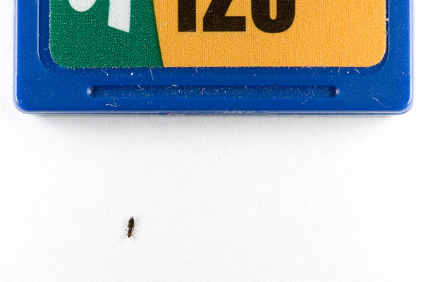

    Indeed, here it is......
    [​IMG]
    (It's a SD card). It would come and go, sometimes disappear but eventually it annoyed me. Still kept the little fella, it's selotaped to my computer stand :)

    :eek: It's incredible that something so large could get in there! The little bugger was determined to go out in style!
    I can't wait to get rid of this black speck on my screen. It looks like a piece of light seal foam or something. Very annoying.
