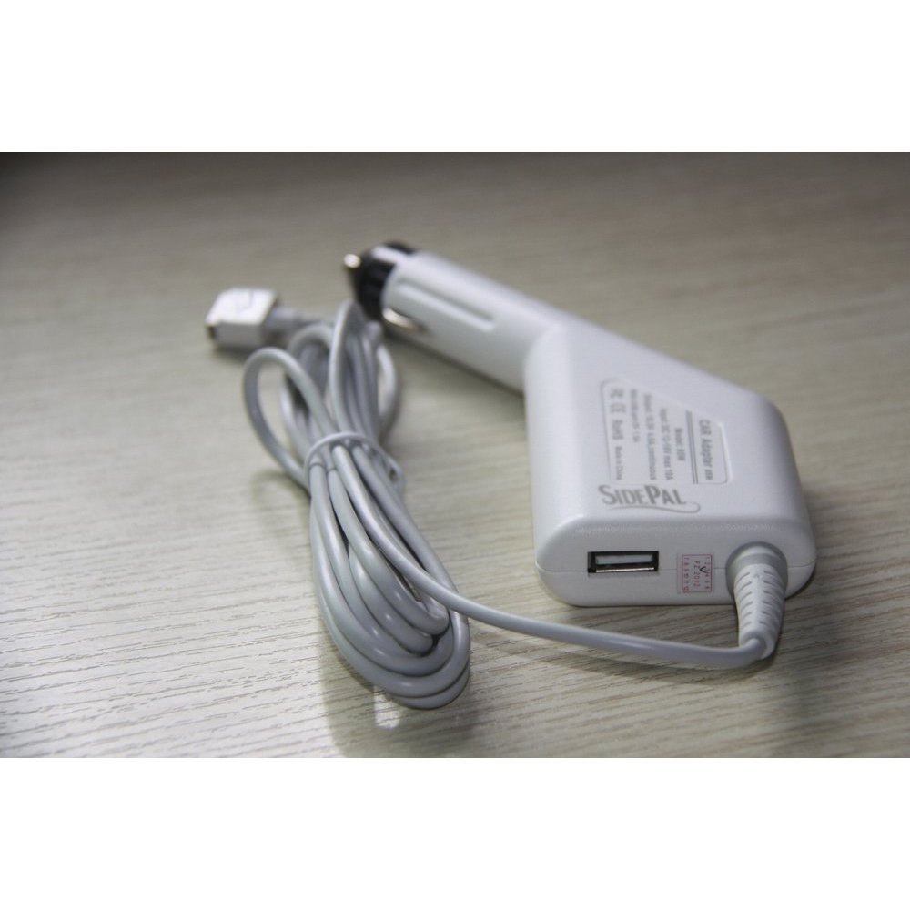

  2. Giuly macrumors 68040
    Giuly
    #2
    A MacBook takes something between 16.5 and 18.5V, iOS devices 5V. Converting the 12V from your car to 120V, then back to lower voltages is probably the most inefficient route you could possibly take.
    But the 85W MacSafe charger with integrated USB port to the rescue.
    [​IMG]

    Yeah I used to run a carpc and used a small power supply to boost car 12V to about 18V.

    Like Giuly said, you can just use a car adapter since both the cars battery and your battery on your mobile device are both DC current powered. All it does is transform the 12VDC into 5VDC for ipad/iphone.
    In fact, if you are concerned about the "quality" of the electricity going into your device, the car setup Giuly linked to is probably better than plugging into your house electricity anyways since the power bricks have to both transform and rectify the power from 120VAC into 12VDC.
    If you are having issues with your touchscreen, I'd look at other possible issues first.
