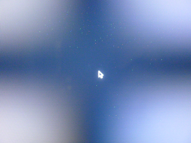

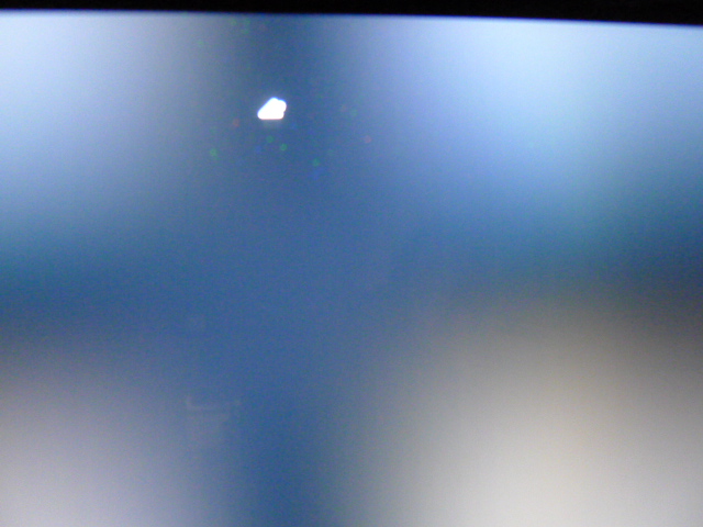

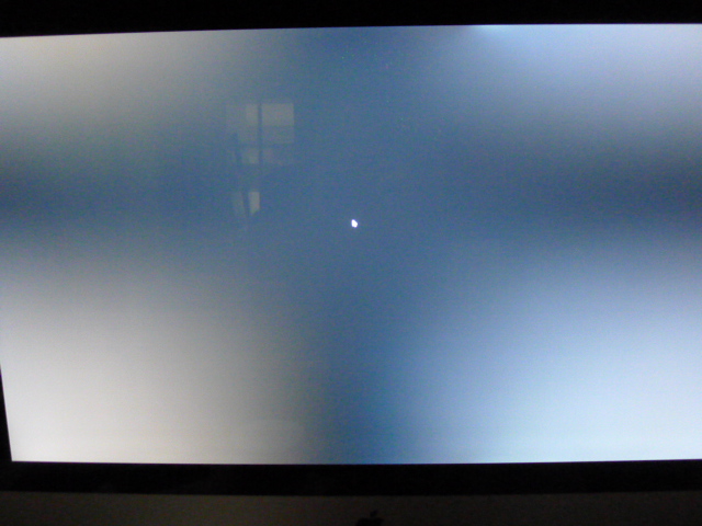

    So here are the pics, my apologies as I just pulled out a pocket camera and it's obviously difficult to take a photograph of a dark screen;
    Top Middle of Screen
    Right Edge of screen
    Entire Screen

    I made a genius bar appointment and took the machine in to Apple today. The Apple guy said that he had never seen a screen with as many dead pixels as mine had. He said the best way to rectify it would be to order a new panel and then have me bring the Mac back once it is there in stock and they will replace it in the store, turnaround time once they have the part is about 24 hrs.
    He said that they have done several of these and never have had to do a 2nd one, as the replacement panels go through a special QA for 2-4 hours of testing prior to going into the replacement parts inventory.
