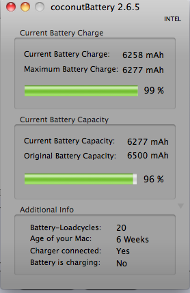

ncdasa
macrumors member
May 11, 2009
81
Ok, thanks Surley. I just installed coconut and this is my readout :
Unfortunately, I dont know all too much what any of this means, so if anyone feels inspired to explain any of it, I would be greatful. I can say that I bought this computer refurbished on Dec. 23rd and have hardly unplugged it. I have heard that the body is always replaced when refurbished, but cant remember anything about the battery. At any rate my point is that, presumably some of the load cycles are from the previous owner/user because I am sure I havent charged it 20 times. I have rarely unplugged it so far and mostly did so only to test it.
