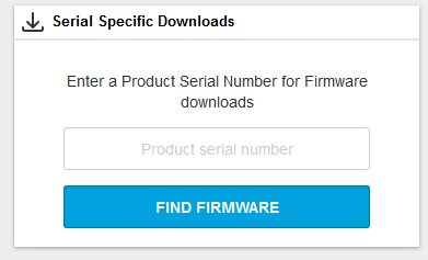

You can also check for firmware updates here: http://www.seagate.com/gb/en/support/external-hard-drives/desktop-hard-drives/backup-plus-desk-mac/
Towards the bottom, there should be an option to find firmware updates based on your serial number (as there are a fair few different models), to ensure you're downloading the correct update.
Is it still under warranty? It may be worth speaking with Seagate support too.
Went to the site, typed in the serial number, and I got red text saying there was no firmware found for this serial number
