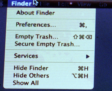

    Example image: These menus should be translucent and uniform. The defective LCDs render the menu with pinstripes and bands:
    [​IMG]

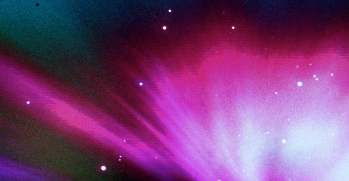

    The "Aurora" default wallpaper has severe banding with the 9C5B LCD:
    [​IMG]

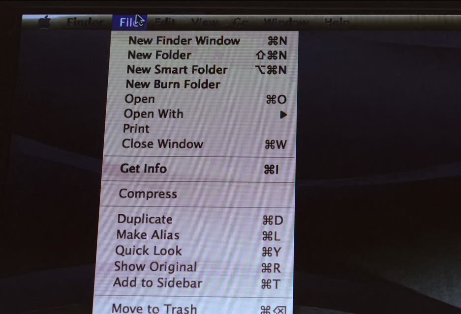

    Macro shot - if functioning properly, the LCD should display this entire menu without lines. The top half of this image is fine, the lower half has lines running through it. The graphic below this menu has a region of light solid color underneath "Show Original" and "Add to Sidebar":
    [​IMG]
