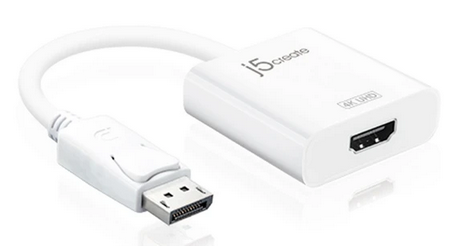

No bootscreens but . . my Display port is working.
This Active HDMI to Display port adapter works works with my MSI Armor RX 580 8gb. in Mojave 10.14.6 build 18G5033.
But does it work in Catalina? There I have my problem. Mojave works anyway.
