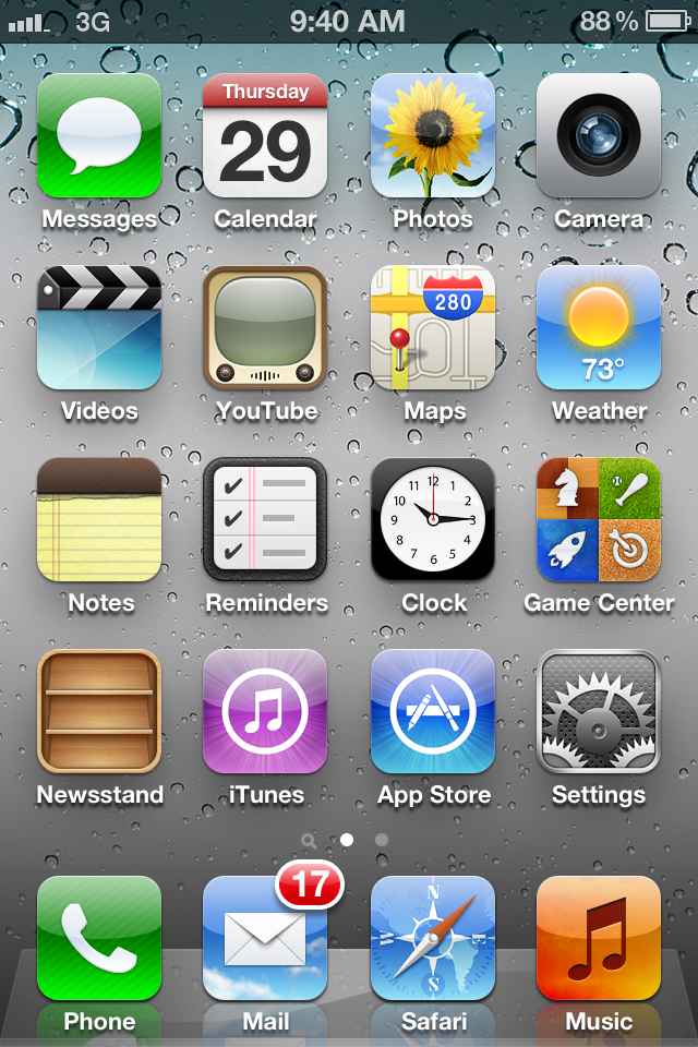

    Was this a feature in the last update I no longer have a carrier showing on my iPhone. It looks like a photo from the apple website. My service has been pretty bad too even though it says I have full bars wit download speeds < .15mb

    sorry in lecture so im doing this low key haha

    Probably a silly question, but have you rebooted the device recently? When did the issue start?

    yup I restarted, and I had just upated to 5.1

    I'm going to guess that you're on an Alltel plan, am I right? The reason it is showing up that way is the 5.1 iOS update changed the carrier settings, and your Alltel prl is apparently not flagging your SID as a Verizon system. My wife's 4s does the same thing when we are in our home area, which is an Alltel converted area. It shouldn't be a big deal though, everything should work just like it did before. My guess is that Verizon will push a new prl after enough people complain.
    Out of curiosity, what prl are you on? (settings--general--about--carrier--then tap where it says Verizon 12.0)
    There's a thread about it on Verizon's forum. See here: https://community.verizonwireless.com/thread/770205
