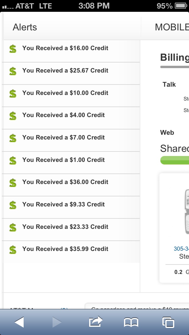

    Here is a little update to the thread. I chatted online with AT&T and let them know I was pretty peeved at being lied to about the cause of my problem by tech support. After a little back and forth, here is the result. About $180 in credits to my account and a credit balance of $100.32. Pays to voice concerns with them.
