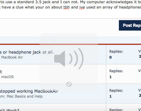

when looking at my sound option firstly the icon in my top right is greyed out.

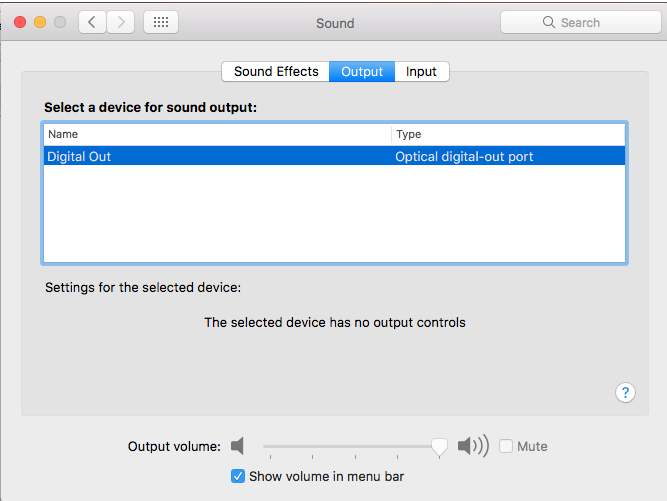

secondly when i go into system preferences its has the device located but says the selected device has no output controls.

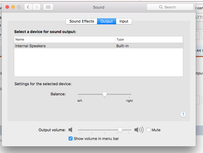

Yes when i dont have anything plugged into my audio jack it shows like this. if i plug in my headphones etc it will switch to digital output but i cant do anything with the controls they are greyed out.
so no, it is nothing to do with my internal speakers not working as i said earlier in my post. and thank you for a link that i specifically said was no use, very cleaver.

It's normal when you use SPDIF.. Use the volume knob on your stereo.
And if your signal chain looks like this...
mac--->DAC---> power amplifier--> speakers
you'll need a preamp (aka "the part with the volume knob and the source selector")
mac-->dac--> preamp--> power amplifier--> speakers
(an integrated amplifier combines preamp and power amplifier, a reciever often adds in a DAC along with the usual tuner and preamp section)
If you want to use the port for analog devices (like ordinary headphones), there's a mechanical switch inside the jack that sometimes gets stuck in digital mode. Look here for suggestions on how to clean it:
https://discussions.apple.com/thread/4571999?tstart=0
If you want to use the port for digital devices-- sorry, that's simply the way it is. For the mac to actually change the volume of the digital out, it would have to start throwing bits away... Instead, use the volume knob on your preamp/speakers/mixer etc.
Do i have to repeat myself. Are some of you illiterate or just a bit simple, sorry but Im getting frustrated here. it honestly feels like some of you are trying to wind me up. There is no red light so its not stuck in digital out this has nothing to do with my internal speakers either they work fine. Please stop telling me this if it was that i wouldn't be asking here would i.
I just want to use a standard 3.5 jack and I can not. My computer acknowledges it but wont let me. as for this preamp thing i dont have a clue what your on about tbh and ive used an array of headphones and speakers none work.
there is something stopping me from using my 3.5mm jack. i know its just gotta be some stupid setting somewhere.

You are stuck in digital mode, red light or not red light.
It is NORMAL not to have controls in digital mode.
If you were not stuck in digital mode, your output would say "Headphones" instead of "Digital Out" !
Using standard earphones or headphones requires an analog output, not a digital one.
Do you understand, finally ?
If not, CALL APPLE, ok ? Not us, illiterate and simple.
