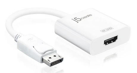

I have no problems. I use an active Display Port ( HDMI to DP ) adapter.
Bought it here in Japan for ¥1,400 years ago.
