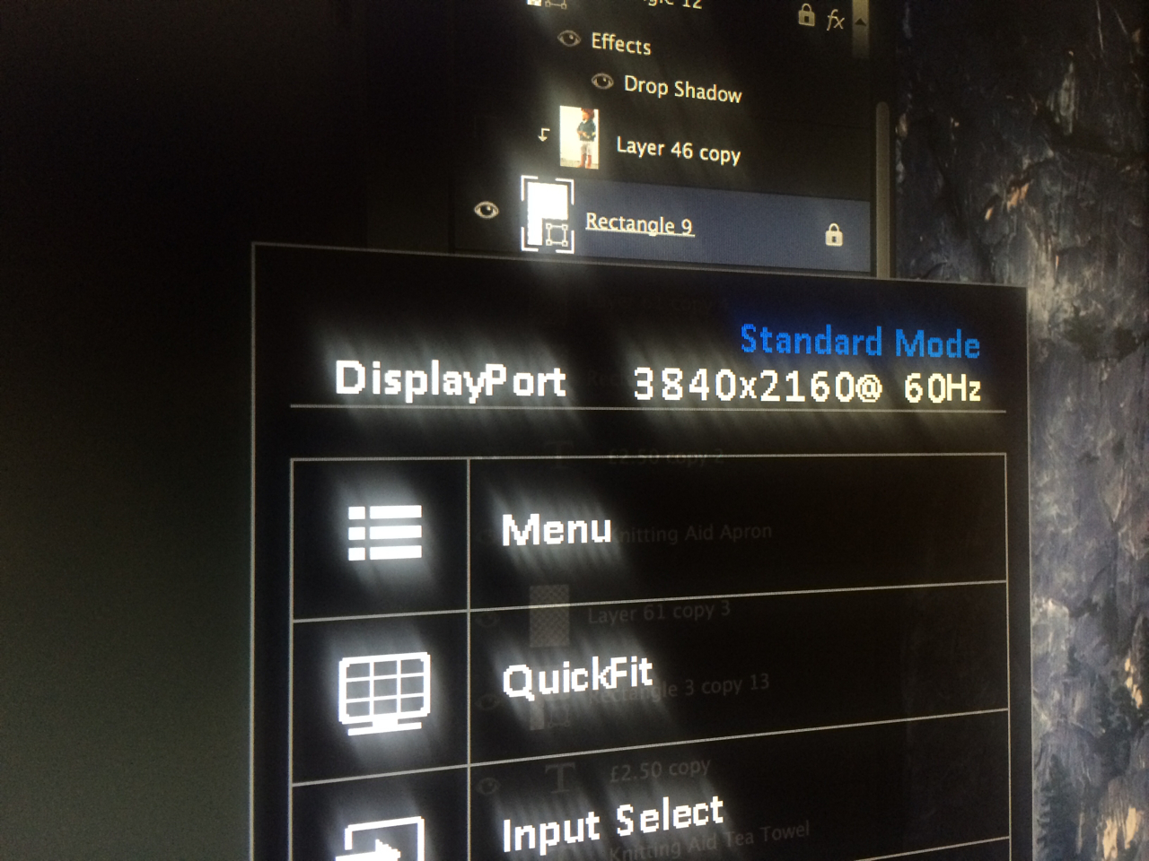

Hey, I just saw your thread here and I wanted to ask a question, since I'm having problems with my own ASUS 4K display (PB287Q).
I've put all of the details in a thread over here. I've got 4K picture via a DisplayPort to Mini DisplayPort cable, and it looks great. No complaints in that department. I'm running the display at 3840 x 2160 @ 60HZ and have the display set to Scaled (Looks like 2560 x 1440) in System Preferences.
The only problem I'm having is I'm experiencing what feels like a bit of lag, it doesn't feel as responsive as my other Macs, for example. When set to the setting above, the mouse still feels slightly laggy and more noticeable is the playback of videos in YouTube. They stutter and artifacts appear.
Is this a problem with the Mac or the Display? Will an Software Update down the line fix this problem or should I try and return the display (I'm not even sure they accept returns once you take it out of the box)? And finally, are there any solutions to working in a 4K environment without splashing out £3K on that Sharp Display they're selling on the Apple Store?
Any help is appreciated. Thanks!

@realph: Once I got mine at 60 Hz, I didn't notice any more lag, and no artifacting when watching YouTube either. I doubt its the fault of the Mac Pro (Late 2013) since it should be able to handle it. I am no expert, but my guess is that either the monitor or the cable is causing the problem. Perhaps trying the cable I bought (mentioned above) would be a good thing to test. Its not expensive.
I have a new issue I need some guidance with. I am unable to play HDCP content from iTunes on my new Asus PQ321Q. It claims that my display is not HDCP compliant but surely it is. I tried resetting SMC as advised in some threads and no luck. (Obviously also reset, etc.) Any tips?
This was the cable I bought: http://www.amazon.co.uk/StarTech-co...92&sr=8-1&keywords=minidisplay+to+displayport
Do you see anything there that might be causing the problem?
I haven't moved across my iTunes library yet, but I'll let you know how I get on with HDCP content.
Just a footnote, but I've just realised that YouTube can't play videos in fullscreen. I can hear audio but I get a no picture, just a black screen.

That cable probably isn't DisplayPort 1.2 compatible which may be the problem.
Another update. Apparently the cable is DisplayPort 1.2 compatible, but I have no way to check if this is correct.
Lag/jerkiness is obvious when resizing windows on the Mac (Chrome, specifically). Which made me wonder if it was maybe the browser. So, I downloaded the nightly build of Chrome (Chrome Canary), and resizing feels snappy, YouTube videos play great (even the few 4K ones) and overall it feels good. I'll post updates as I get closer to the issue.
