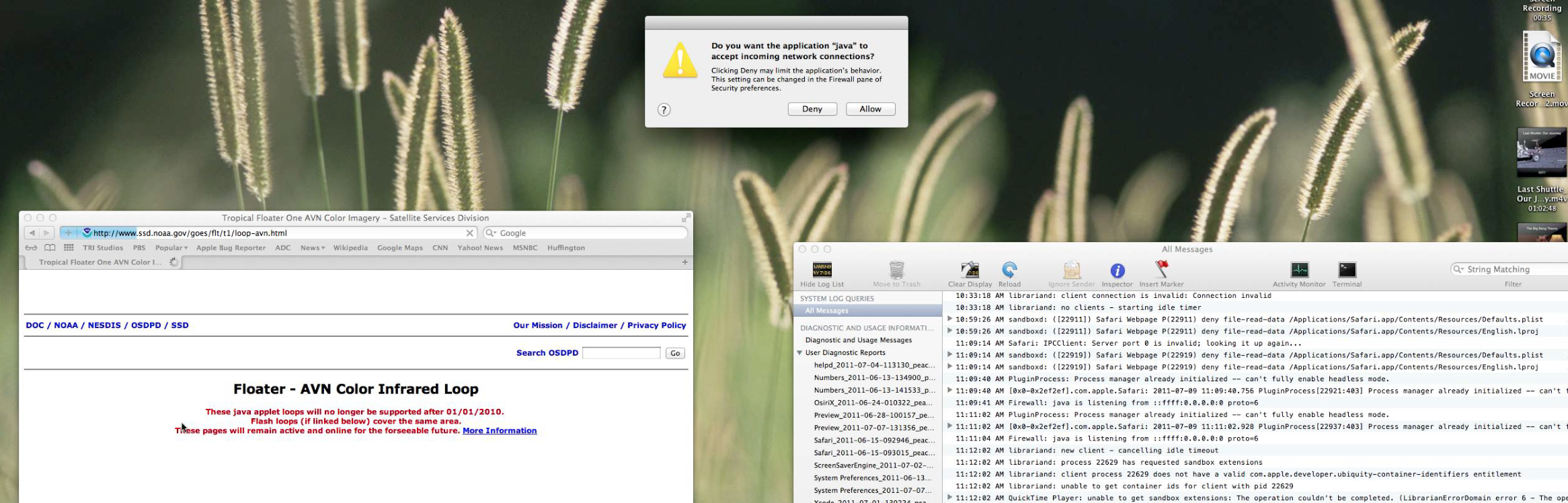

    It's the old java pop up bug. I've seen it before and I thought it was supposed to be fixed in 10.8.3
    Here's a pic from my bug report. This is probably what you're seeing.
    The pop up dialog appears for about 1/100th of a second.

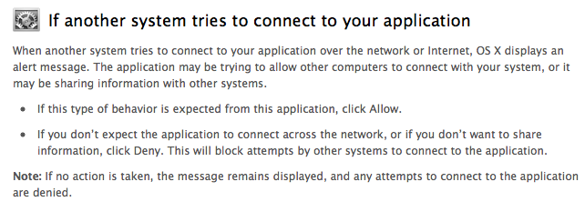

    Java might be the culprit, then! I have yet to capture my error. By accident, however, I clicked question mark icon in the dialog box at the exact right time. This caused the Help viewer to pop up, and it is indeed a firewall request.
    All the ways in which I hate Java could fill a library.
