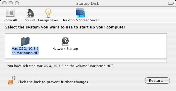

    i would go to your start up disk in system preferences and make sure you have osx clicked on.

    You want it to look like this...
    Is there any way to get rid of the network startup icon? I'm never going to use it and it will just solve the problem of it getting accidently selected again.
