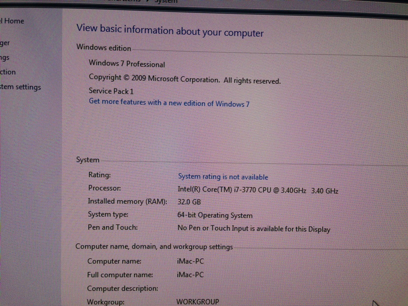

    No issues here with 32GB RAM 2012 iMac running Windows 7 64bit.
