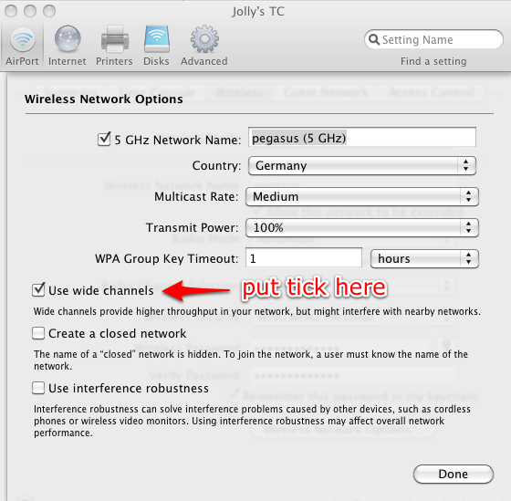

    The Wide Channel option is no longer an option with the newer versions of Airport Utility (6.3). I'm assuming that this "option" is turned on by default.
    Any other ideas?

    Well, my Late 2008 Unibody MBP connected to AirPort Extreme with 300Mbps (5GHz, wide-band, ie. 40MHz bandwidth). So the antennae can't be a reason.
    The iOS devices are a different story. Their Wi-Fi (at least up to iPhone 5) is limited to 65Mbps only. Because of single-antenna, narrow-band (20MHz bandwidth) setup in 2.4MHz frequency band.

    Out of curiosity for those that are getting 300 transmission rates, did you upgrade your new AE from an old AE with the wide channel setting activated? I'm wondering if this setting got transferred over if you had it set up with an old AE setting but if you didn't have this setting activated to start with, it won't allow you to do so now with Airport Utility 6.
    I tried downloading the old Airport Utility 5.6, but it won't let me install it now.
  11. pup975 thread starter macrumors member
    Joined:
    Jun 30, 2007
    #11
    Actually, that was it! I found a post on the Apple Support site that details how to run Airport Utility 5.6 if you've already got 6.0+ above already installed. (Below are the instructions for anyone else having this issue.) Once I ran 5.6 and checked the wide channel option, I now get 300+ transmit speeds. Seems like this should have been activated by default, or at least this option should be reactivated as it doubles your speed when activated.
    Anyone know of why this would be disabled by default (or maybe it isn't and just was my settings that got transferred over)? Any disadvantages to having this turned on?
    Instructions:
    Note, it will tell you that 5.6 is not compatible with the new AE, but go ahead and proceed.
    1. Download the free application "Unpkg" unpkg-4.5.zip file here: http://www.timdoug.com/unpkg/ (it should automatically unzip)
    2. Go to the "unpkg 4.5" folder in your downloads (or wherever you saved it) and drag the "unpkg" app into your Applications folder.
    3. Download Airport Utility 5.6.1 here: http://support.apple.com/kb/DL1482?viewlocale=en_US&locale=en_US
    4. Go to the downloaded AirportUtility56 file and double click it to open the installer (AirportUtility will appear on your desktop).
    5. Double click on the AirportUtility dmg on your desktop (a new Finder window with the AirportUtility56.pkg will open).
    6. Open your new Unpkg application.
    7. Drag the AirportUtility56.pkg onto the Unpkg app window.
    8. A new folder, "AirportUtility56", will appear on your desktop
    9. Open the "AirportUtility56" folder and go to Applications > Utilities
    10. Drag "Airport Utility 5.6" into your Applications folder
    That's it. From now on you can open Airport Utility 5.6 to use it. I noted that Airport Utility 5.6 doesn't appear in Launchpad (likely due to the fact that it wasn't installed normally), so you have to open it from your Applications folder is all.
