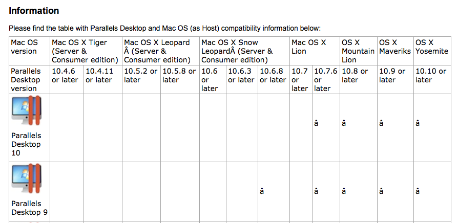

    so what is this then?

    That looks to be the chart that shows what versions of Parallels can be installed on what versions of Mac OS X. Not what versions of Mac OS X can be installed in what versions of Parallels.
