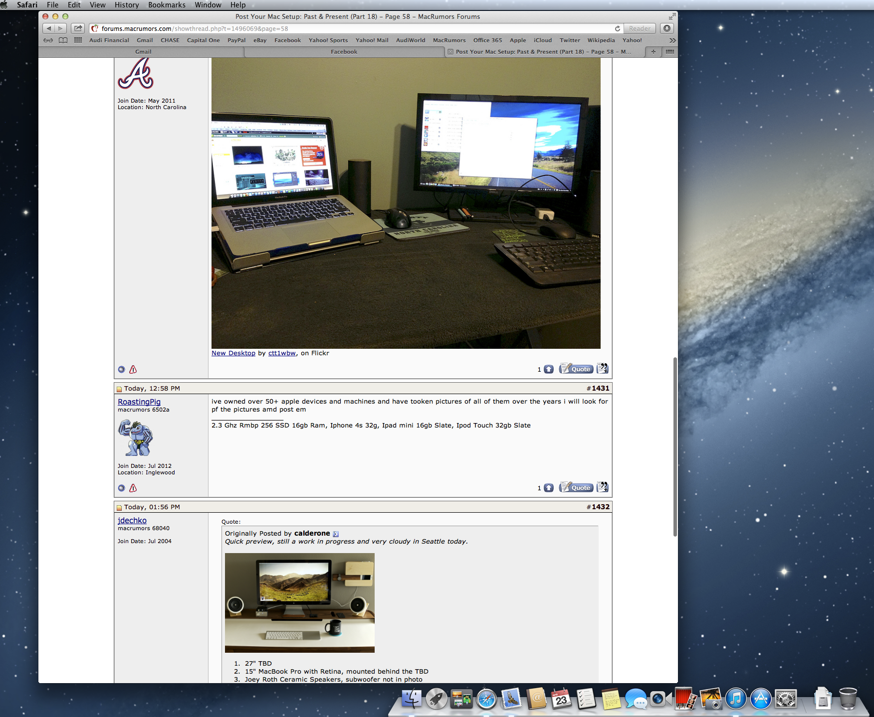

    well here's a print screen, but i dont know if it looks the same on my screen as it does on yours.
  19. cramazing thread starter macrumors 6502
    Joined:
    Jun 17, 2012
    #19
    so Im looking at the picture from my work monitor and it looks perfectly fine...
