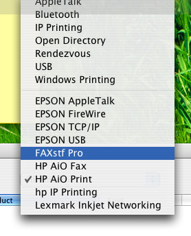

    I'm guessing that you are trying to add the printer by selecting it from the "USB" printer list. When installing HP drivers, HP will generally add its own Printer List type. Look for the HP LaserJet 1012 choice in the Printer List drop down list.

    This is the list I get, and none of the options install the printer correctly.
    [​IMG]
    Any other suggestions, please?

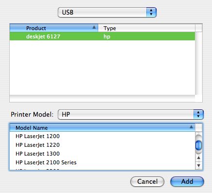

  7. emw macrumors G4
    emw
    Joined:
    Aug 2, 2004
    #7
    From the HP.com website:
    This may mean that if you're running 10.3.x you're out of luck.
    You could try selecting another HP printer from the HP drop-down list...
      File size:
      24.3 KB
      Views:
      39

    I don't think I have sucessfully been able to get to that screen that you just showed.
    It always says "printer model: auto select" and it is grayed out. I can never drop down the list and select a model.. how did you do that?

    You have to select the printer first (make sure it is highlighted in blue as in the screen grab) then it should work.
