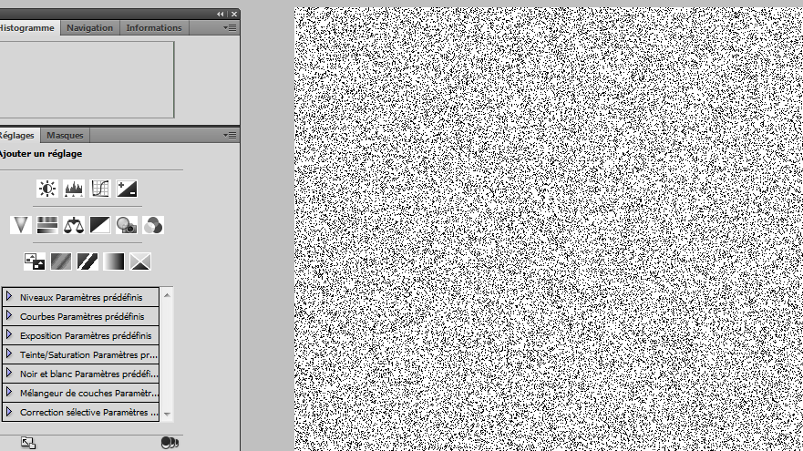

    hello
    i'm not in gogd in english, so excuse me .
    Well, i want to do a rain effect. So, i use the noise filter and after i use threshold setting mode by the layer blending modes
    When I add noise to a new doc and I pass by setting the threshold to decrease blackheads, everything passes well until I valid threshold. Then the noise comes back to the initial state where I had put it. in fact it is as if photoshop had not validated the phase "threshold setting"
    Also the histogram is flat.
    I attached a picture of the result, knowing that the threshold is set to total light tone
    I said it happens the same way on different computer with different systhem of exploitaion and under different version of Photoshop (CS2 CS4, and CS5.5)
    If anyone knows the why of the matter ....
    Thank you for your help

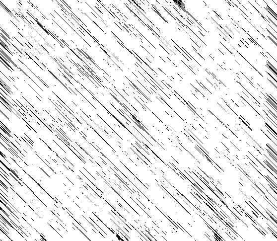

    I must admit, I'm not sure what your problem is.
    But if I take your file and put a motion blur on it, and then adjust the threshold, I get something pretty close to rain.

    Hello
    1 NOISE
    2 seuil
    3 wind tunnel
    But with my computer, is not possible to validate the step seuil.
    Bye
  4. citizenzen Suspended
    Joined:
    Mar 22, 2010
    #5
    Your image looks like it's in Bitmap Mode.
    The histogram, the image itself and the fact that Threshold is grayed out would indicate that.
    Check the pulldown Image > Mode and see what it says. You need to be in Grayscale or RGB to get to the next step.
