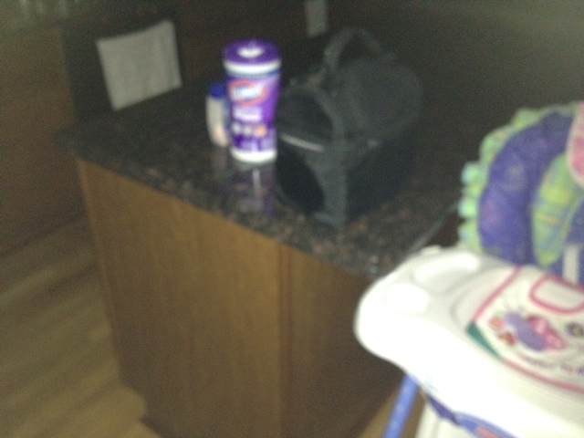

    Whenever I take photos at night or in a dark room they always come out looking "washed out" and faded. Is there a problem with my flash or maybe my camera? Anyone have similar problems? Thanks!
    [​IMG]
    Image: http://i.imgur.com/bcCdk.jpg

    Are you familiar on how a camera works?
    Flash at night time pictures create the washed out effect on photos.

    If you have any case on, remove the case, then check if you forgot to remove the protective layer in front of the camera, then reshoot. Did it improve?

    the led flash on the iphone isn't that good for wide open areas at night. It works better at close range. Also some iphone case will affect flash more than others. Sometimes if you have ur finger too close to the flash it bounces the light weird into the lens.

    You do not take night time / low light pictures using a flash or else the results will be as above...

    That's definitely something interfering with the flash. If you have a case on, take it off. If you have something covering or coming right up to the flash take it off. The night capabilities aren't the best, but that blue haze is definitely interference.

    Definitely interference from something. There are some known case issues, notably those that had too small of a cutout for the flash. The light would bounce off the side of the opening and create a haze in front of the lens. The early speck candyshell cases for the iPhone 4 were like this. It could also be the way you're holding the phone and the light is bouncing off of your finger. In no way is this normal behavior from the iPhone flash.

    There is nothing interfering with your camera lens or flash. It's just your environment mixed with using a flash at night in an open area.

    The flash only has a range of a few feet. Turn it off for a shot like that.
    Also the case is probably causing the problem. Take if off or get a case with a larger opening that is made to be used with this flash. The Incase slider is one that works well with the flash.

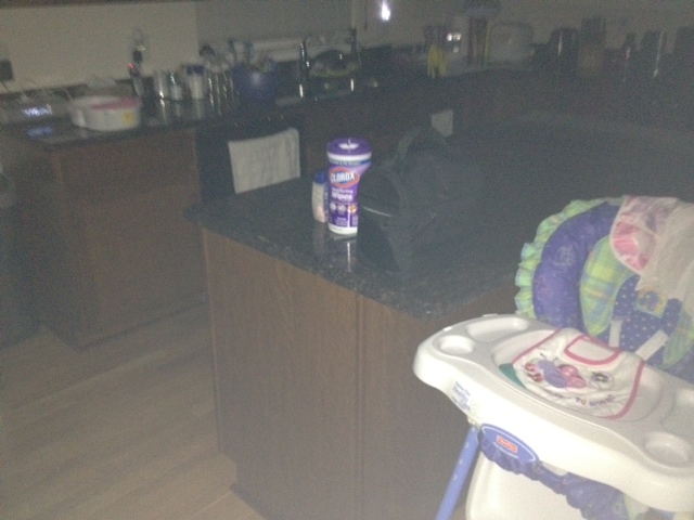

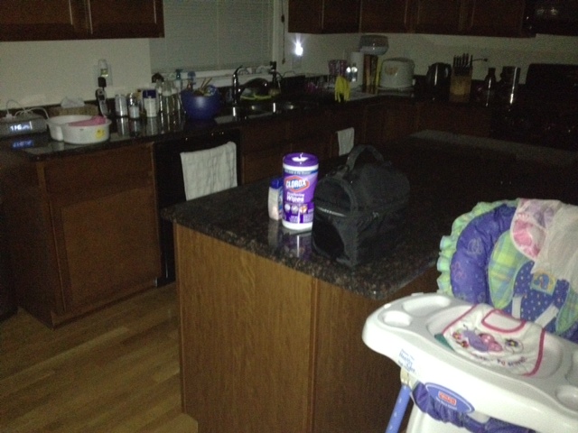

    I was running into this too. Here's what I discovered:
    • I currently have a white 4S which is experiencing this issue, previously had a black 4 which didn't have this issue.
    • Using the same case on my 4S that I used previously on my 4 (smoke colored semi transparent TPU Gel case)
    • Took pictures, got the washed out foggy effect with 4S with case.
    • Same picture with my old 4 with the case, did not produce the foggy effect.
    • Removing the case on the 4S also make the foggy effect go away.
    • Tried cutting out a much larger hole on the case, to keep the flash from reflecting off it. Effect is less, but still present. As of now, only cure seems to be removing the case completely.
    Attached are my test shots for reference.
    1. With case
    2. Without case
    3. With case, but larger hole cut out of case around camera and flash (effect is reduced, it's just that the pic is out of focus)
    For me, it appears to be a combination of a white phone, with a somewhat transparent case (smokey clear), as my previous black iphone 4 with the same case didn't have issues. In trying to watch the flash while taking pictures (hard to do without blinding yourself), it appears the flash almost bleeds across the face of the white body and under the edge of the case, causing a reflection when the picture is taken. Don't notice the same thing on my black 4.
    Anyways, debating what to do. Will likely see if I can find another case which doesn't produce the same effect, but if I can't find one, might try to return/exchange the phone at the Apple store for a black 4S instead of white, if this is going to be how the camera and flash work, as going without a case is not an option for me.
    If you are experiencing this issue, and you have a case, I highly recommend you try removing it, to see if it improves for you as well.

    It was a case issue. But it seems to happen with distance shots at night ike people mentioned.

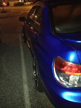

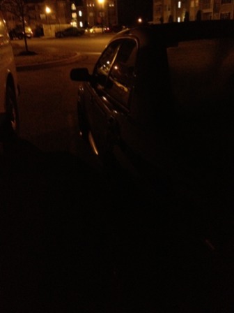

    I tried a similar pic with my 4s cause I never tried it.
    Flash on
    [​IMG]
    Flash off to show how dark
    [​IMG]
    I'm using the newer otter box commuter that has the modified camera opening.
